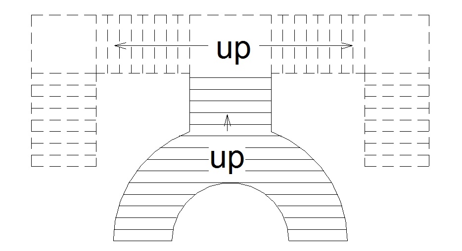

can this be done in revit as one stair only (see attached image)? basically, I have two stairs that meet up half way and then continue as one single stair to later split in two different directions.

the way I see it you have two stairways to create the lower one is going to be difficult to build as the framing and railings will not really work well. the upper ones can be a mirror image.
