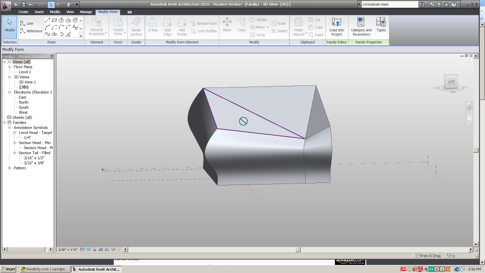

alright, I tried this in conceptual massing mode...still cannot add an edge to the top of a mass. I would like to add a vertical profile actually, but I'll take an edge. Is there any way to do this in Revit, or is this program only capable of manipulating office building type conceptual masses with flat roofs?
Thu, Jun 24, 2010 at 3:01:55 PM | conceptual massing...undulating roof shape
#11
stevek77
Joined: Mon, Nov 3, 2008
29 Posts
here is a screenshot...in this case i added a horizontal profile, but cannot add a vertical on or add edges to the top of the mass. I've watched 5 different videos on conceptual massing now and read through as many tutorials as I can, but nothing. So, I would greatly appreciate any help on this. I've been at this for a couple weeks now - wits end Smile
Thanks in advance.
