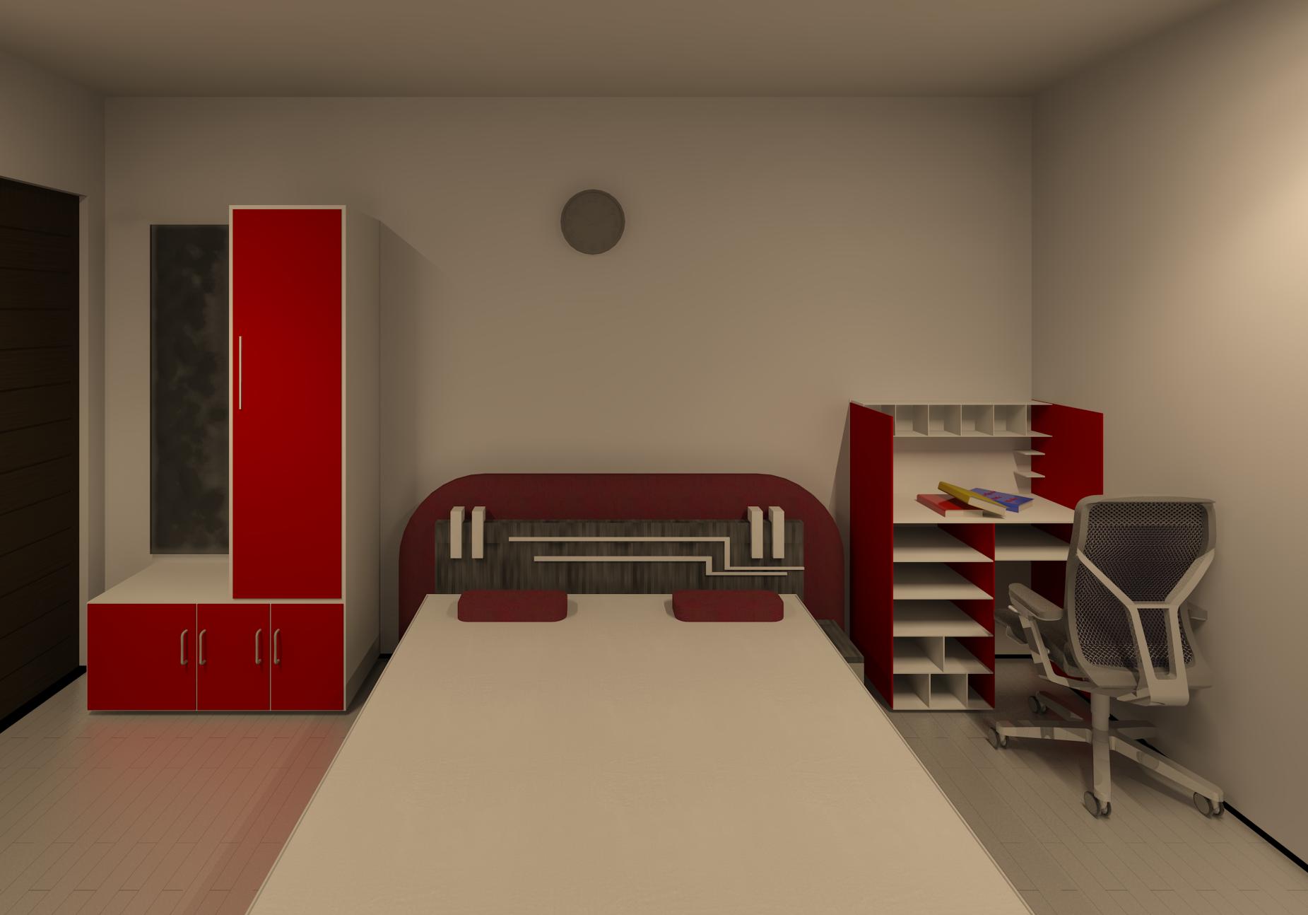

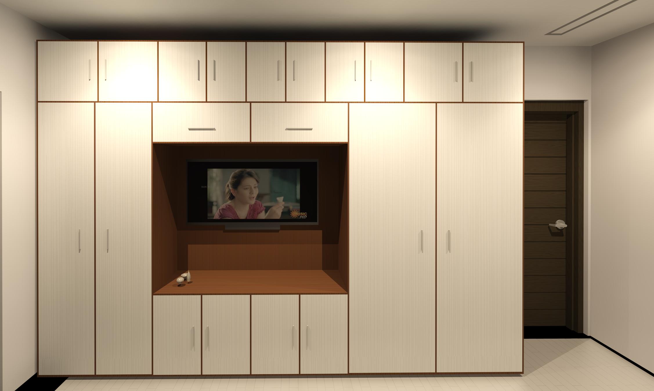

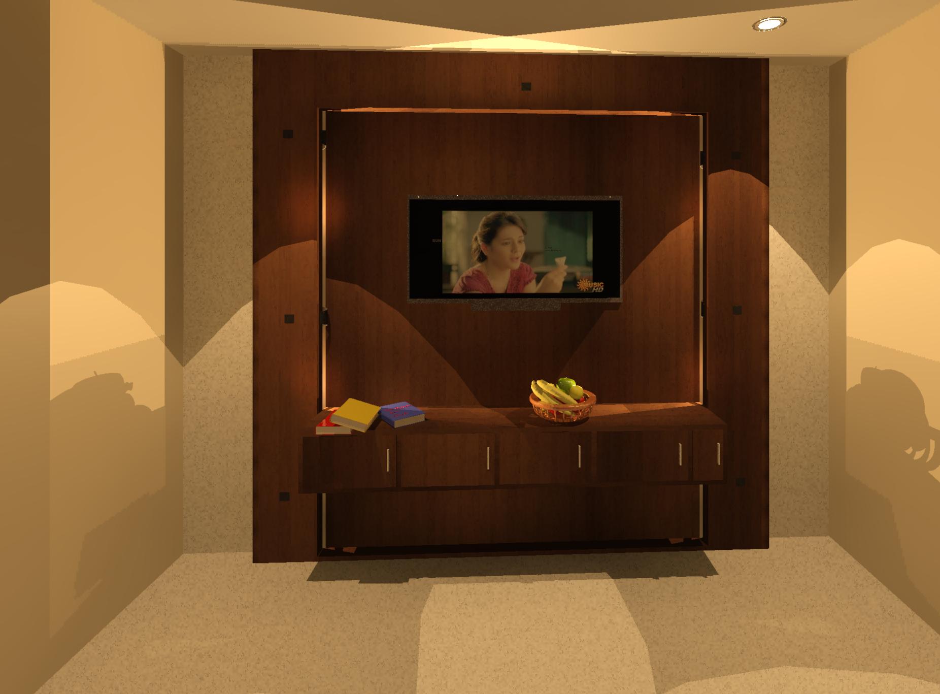

dear sir,
         I need help from your side.when i finish my drawing. before rendering in the reality view .it will not seen clear.the what is my fault in my drawing.please kindly give me the your suggestion to get clarity and clear visual.attached my drawing below.to your reference.
i used REVIT 2016 version.

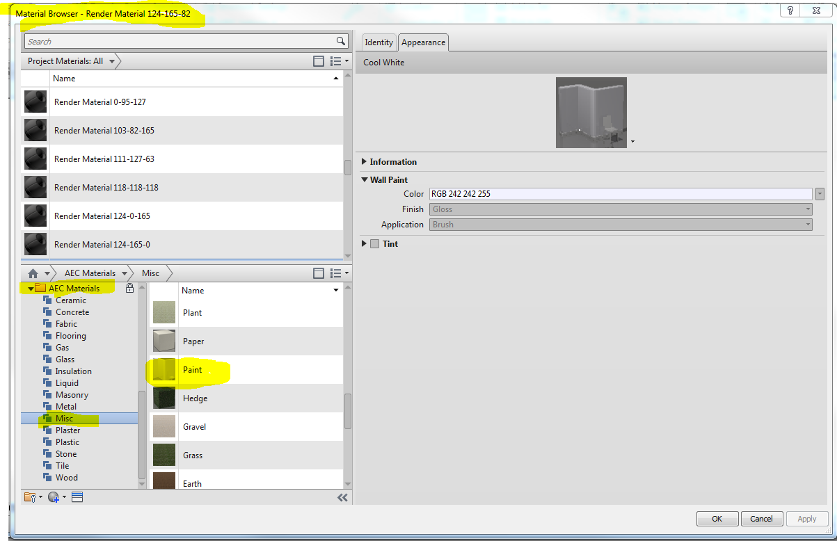

Thu, Jun 2, 2016 at 9:59:20 AM | How to apply paint to walls/choose a colour?? (Revit Architecture)
dgcad
dgcad Avatar
Joined: Thu, Mar 17, 2005
1231 Posts
3.5 Stars: 36 Votes
Looks like you just need to create a new material and start by Duplicating a 'Paint' material which will have all the correct Assets that a paint material utilizes. See Image.
