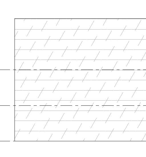

Can anyone assist with getting this to be a staggered pattern?
Verticals and horizontals are where they need to be with the exception of shifting every other row of panels
 I am clueless at this point and have attached the *.pat file in hopes of assistance.
Thanks.

Ok,
Using attached "8x16" block file as the pattern, I can only seem to get the horizontal lines  going how I need them. I am having trouble with the angled vertical lines.  I cannot get them to fall in between and on the ends of the dashed horizontal lines. Essentially i am trying to make a pattern of staggered parallagram panels. I have attached the example pat file, my pat file, and an image of where i am at the moment.
Help is greatly appreciated.

Could you post a dimensioned sketch of the pattern you want to achieve?
Here's the block pattern you posted skewed @ 60 degrees:

Hi Hugh,
I have attached below the desired pattern I am trying for.
thanks

Try this based on 2' x 4' with 60 deg included angle and 1/2" gap, origin at lower left corner:
;%VERSION=3.0
;%UNITS=INCH
*24X48SKEWED60PANEL
;%TYPE=MODEL
;        Pattern written by HatchKit v2.7 Hatch Pattern Editor
;        HatchKit v2.7 Hatch Pattern Editor(c) Cadro Pty Ltd .
;        www.hatchkit.com.au
;-Template=NEW,
;-Date    =24/06/2010
;-Time    =2:41:57 PM
-119.960479335,24,41.569,42.44034332,10.6130334874,48,-49.1160485383
180,48,41.569,12,42.0692194,24,-0.5
60.039520665,24,0,42.44034332,10.6130334874,48,-49.1160485383
0,0,0,12,42.0692194,24,-0.5
The pattern will load to Revit at 1:1 scale (and took about 10 minutes to do and test).
