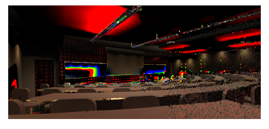

So, I was attaching the maunfacturer's photometric file to the revit lighting fixture that we installing and when I render out I get these funny color bands across the walls, floor and ceilings.....Is there a parameter that I'm not setting correctly or is this the coefficient of utilization that I'm seeing?  I just want a regular render....Any help would be great!
 Thanks in advance!

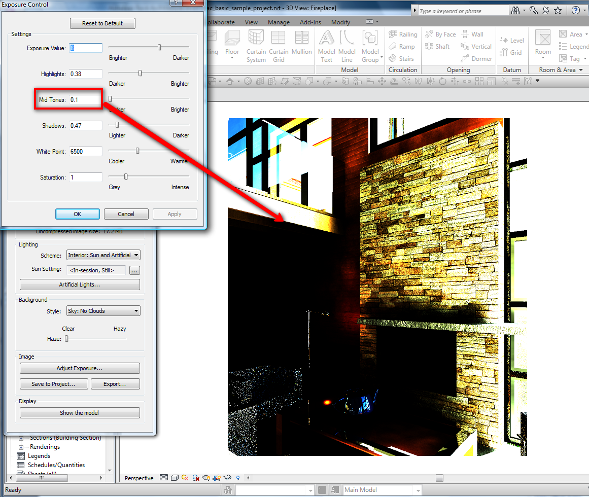

Sorry for the delay but i believe you change the "Mid Tones" in "Adjust Exposure"
photometrics
