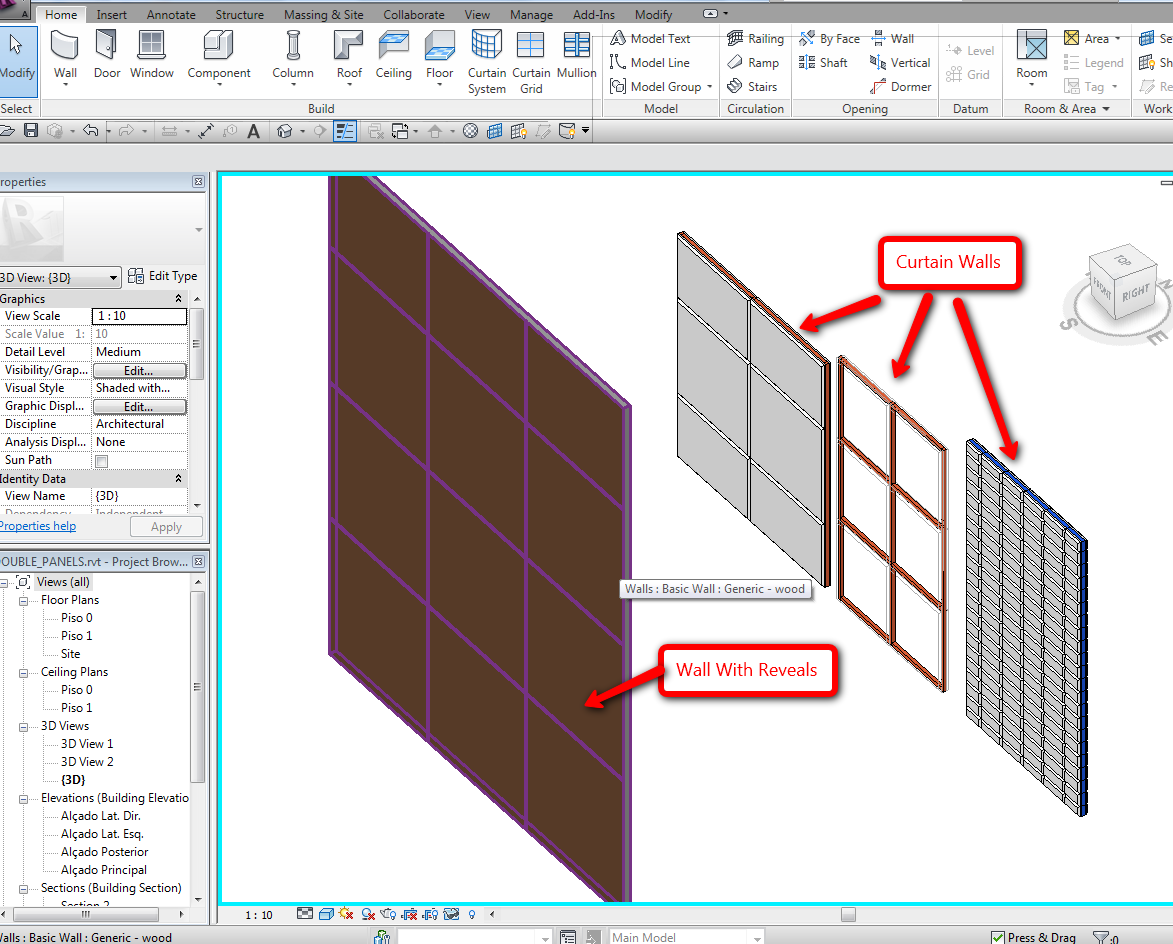

What i am trying to do is making a exterior wall with a wood finish (no problem there)but what i realy want to do is divide the finish layer of my wall in wooden sections of 1440mm x 3600mm with a 10mm space between the sections.

You can create that in several ways, like you can see in my image you can create that by a generic wall with "Reveals" or with "Curtain Walls"
