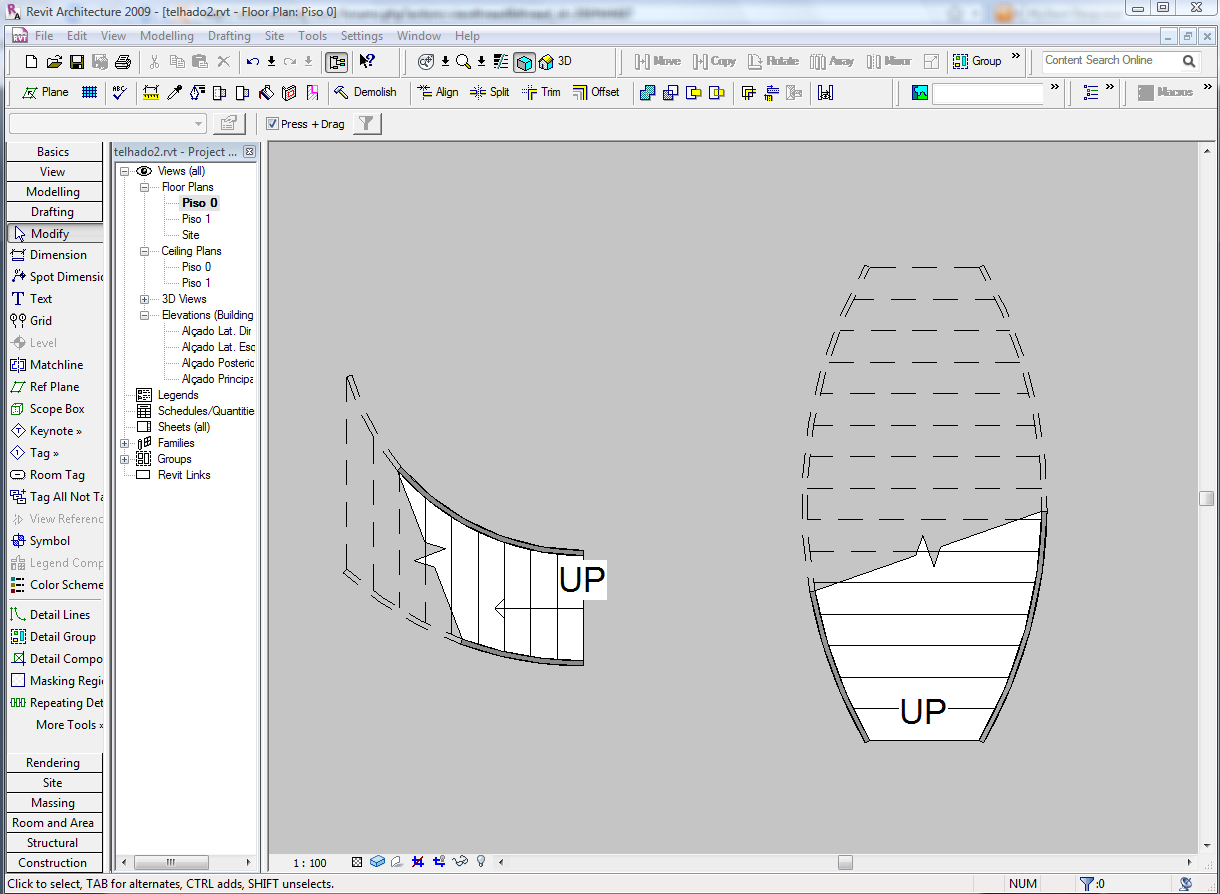

Does anyone know why the stair (and ramps) arrow and text sometimes does not show? I've checked in the stair/ramp properties and the, show text- up label - up arrow are all ticked. It's driving me nuts.

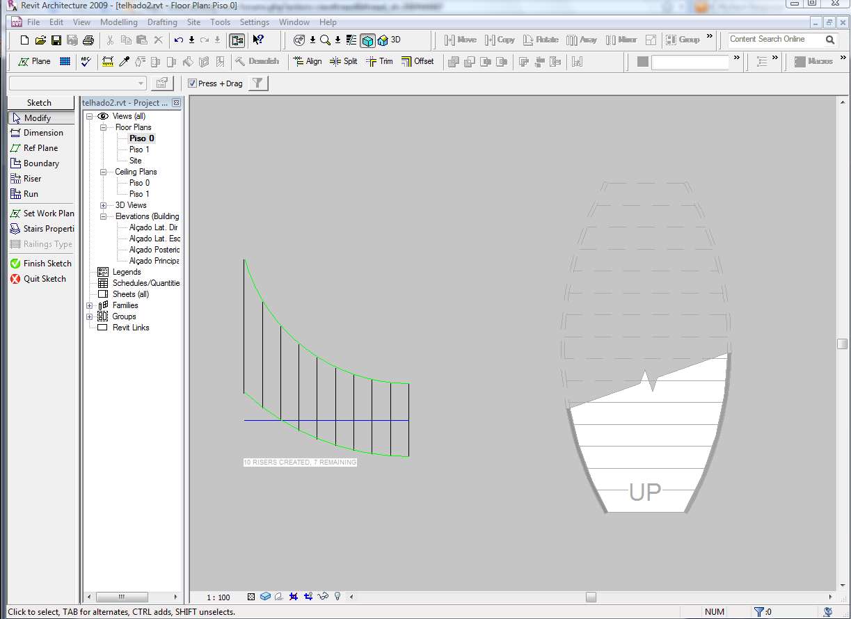

The arrow will only show up if that blue line is present in the stair sketch. As far as I know the only way to get it in there is to use the Run tool and then try copying and pasting the line where you need it, but it's really finicky and can change your stair in some annoying ways.

hi, JRMELLO has right, only if you create your stairs with run appears the UP or DOWN ARROW, you can create that arrow with "Drafting-Detail Lines"...

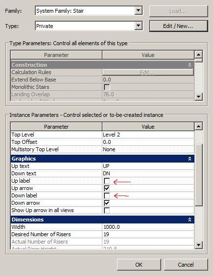

Oooo.. I see... Umm.. I usually go to element properties of stairs, and I will have these options under graphics, have you give check mark to them? Attached is the element properties...

Yes, VICO, try to do a stair like this, (NO RUN) and check ON those box in properties, you will see....

Had a similar problem and discovered that the view range has to be set to below stair also.
