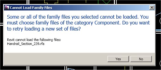

I get this on some family files but not all.  Am I doing something wrong?  Thanks!

Yes, you're doing something wrong.
it looks like you're trying to make a railing?
this you can't do by component, use the railing, stairs or ramp comand instead.
when you open the famillie, choose load into project.
now in jour project draw a railing and select tthe desired railing.

Much thanks!
