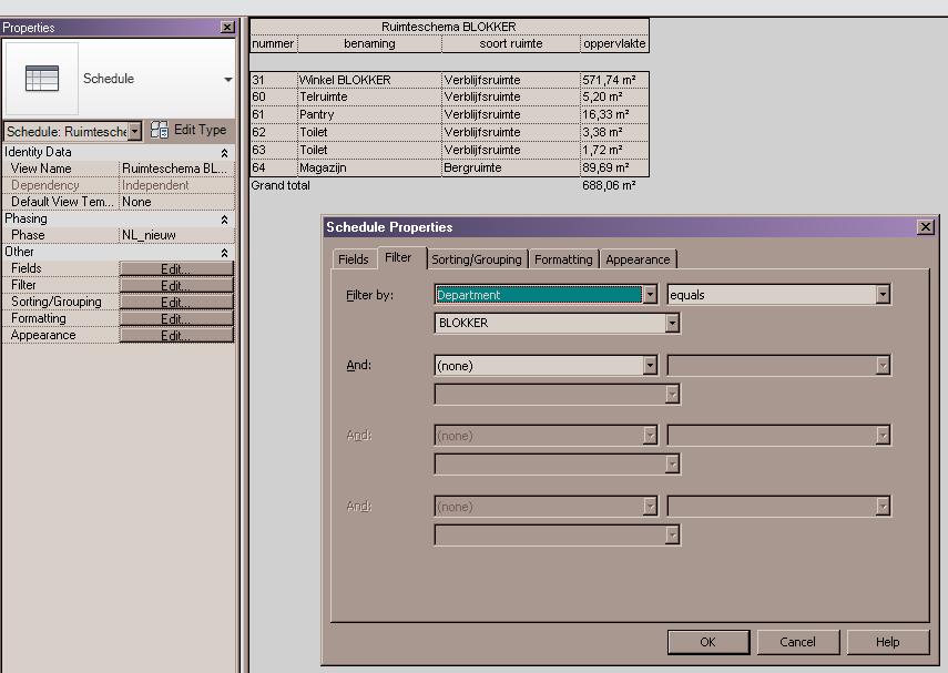

I have a Room schedule key and I want to calculate total area for each room style.  Is that possible?

Yes, this is possible.
There are several possibilities depending on your wishes.
here's what I have done in a previous project.
use the filter in the schedule and filter the roomstyle you would like to calculate (check the image).
this way you'll have to make a schedule per style.
there might be easyer ways, just play with it.
