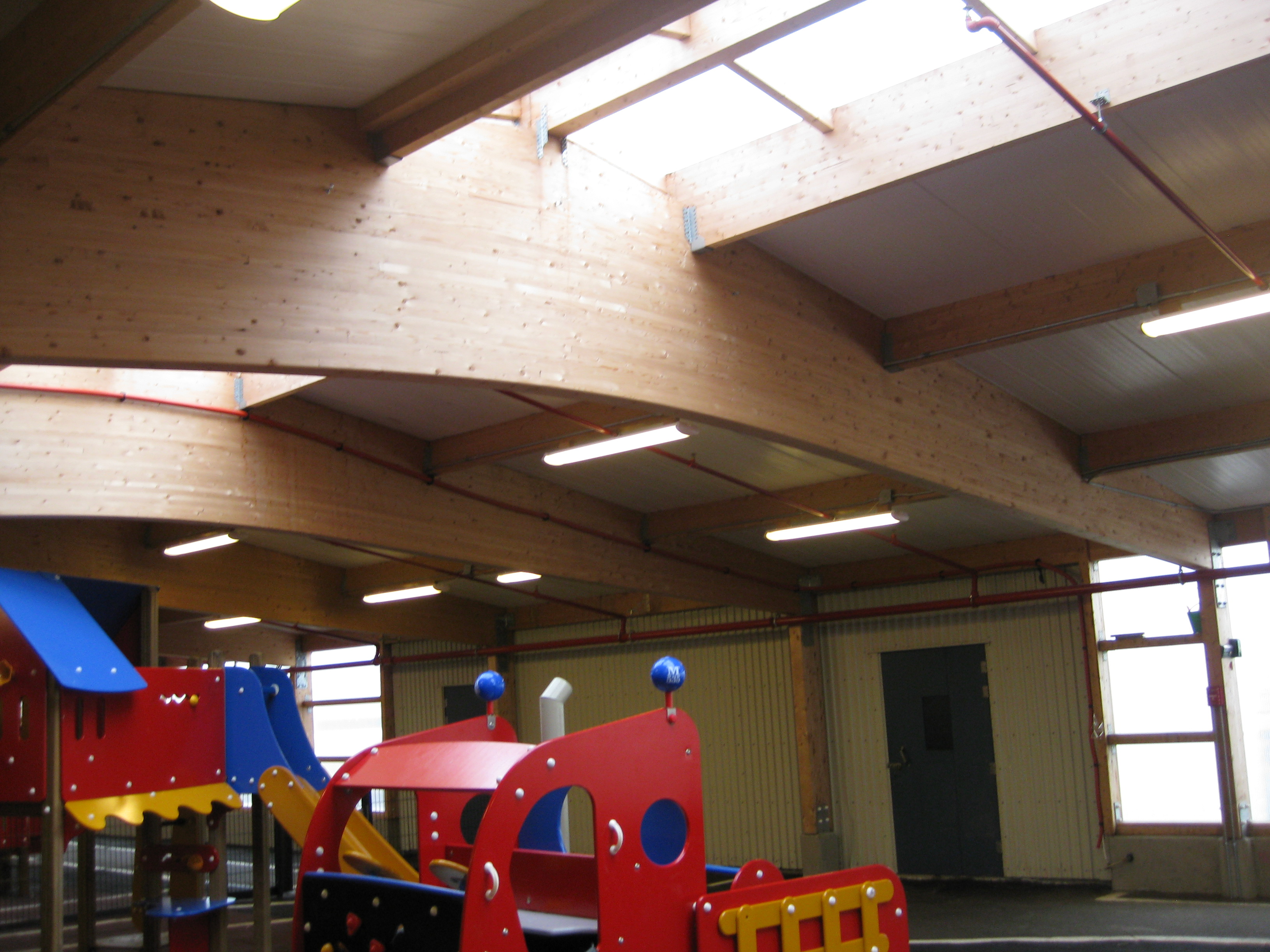

I have a problem doing a beam curved like a boomerang. It is a roof beam that have the lower side curved but the upper one have sharp edges under some anlge, see the attached picture.
Is there somone here that can tell me how to do it or give me a link to a "boomerang" family?
Regards Inga

You could do it as a family.  Make an extrusion that could follow along the beam profile.  See attached (obviously I don't know the profile dimensions but you could edit as required.  Please let me know if this is what you had in mind.

Thank you for this Smile That helped. Now I can edit this one to my dimensions.

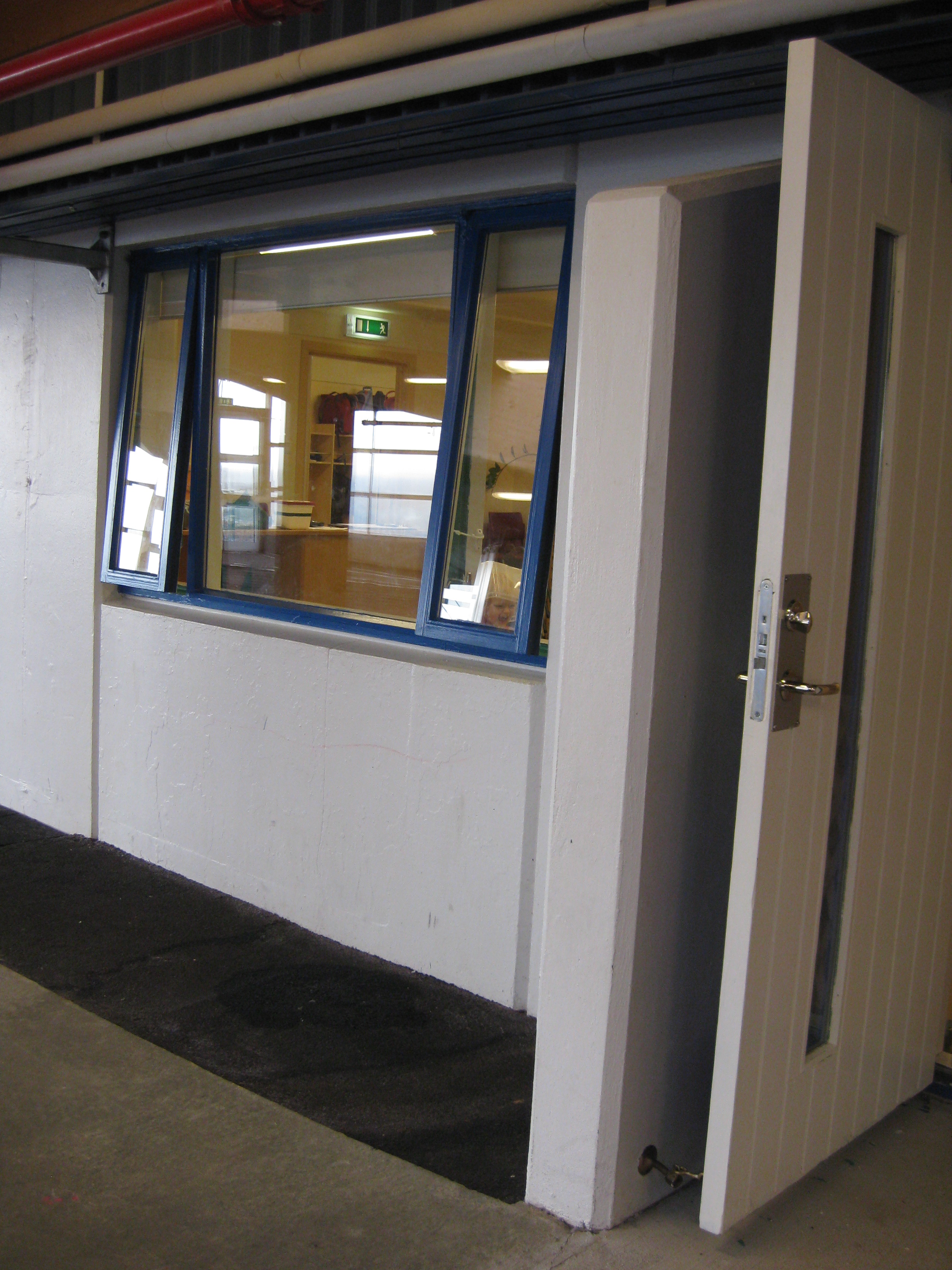

But I have another problem! I cant find a family for a window having two trim like the one in the picture attached. If you have a solution for that I would be greatful Smile

You could model it as storefront, adjust the mullions to match as required for size and location.  You could even add an awning panel which would look correct in elevation.
