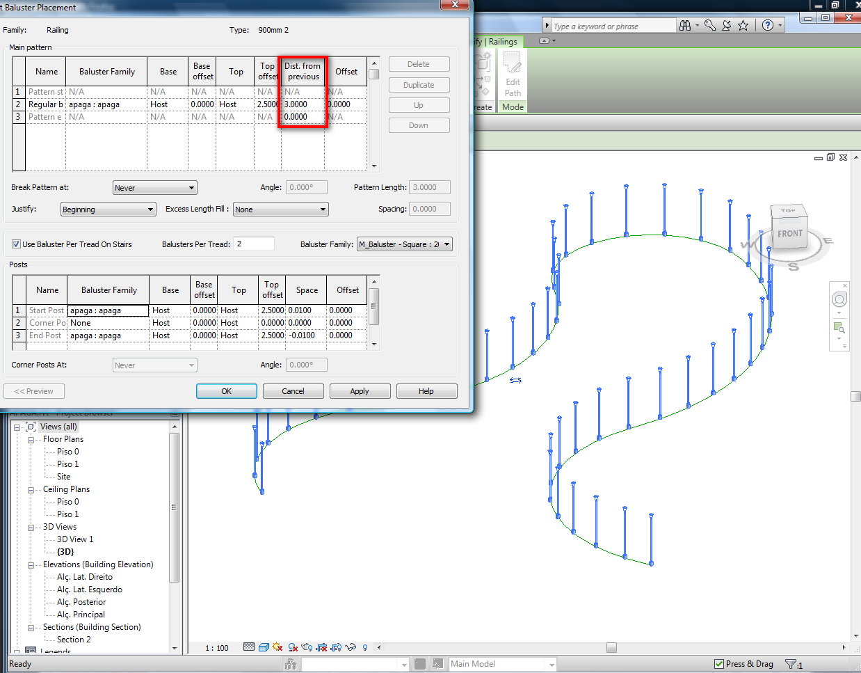

 So is there any way of arraying along something - what could I do if I have a spline instead of an arc ?

You could try using the railing tool and define objects to be arrayed as balusters.  Kind of a Revit hack since the objects become railings, but it does give a more dynamic way to create objects along a path.

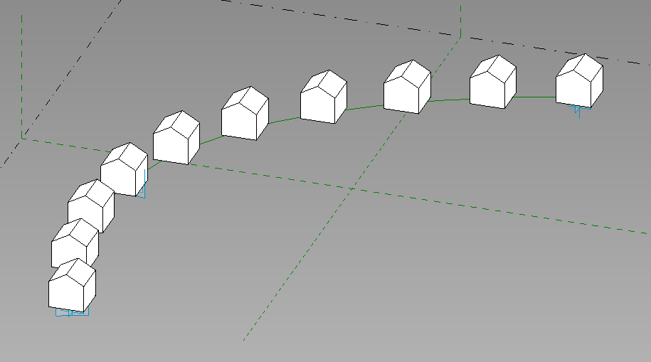

I need to copy some houses along a path and I tried the baluster method, and it's works.
But what if I would like the houses to have the same orientation? is that possible?
Right now they all align to the path.

then, try with adaptive family with Orientation(Orthogonal on Placement) and divide path.
i'm attaching a family i just simply made.
hope it helps.

You may know pattern based family. Pattern based family is one kind of adaptive. But it has to be placed at grid of mass face in common.
But Adaptive family can be placed anywhere in project. Number of adaptive points are the order of placing.
The family i attached above has three adaptive points. It means you can place it in your project with three clicks.
You can find lot's of information about adaptive family on internet and autodesk wiki.
And there are some posts also in my blog.
Hope it helps.
