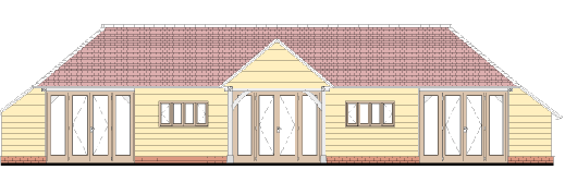

Hi,
Was wondering can anyone point me in the right direction, i want to apply a hatch pattern to a surface with horizontal lines but differntly spaced from large gaps down to small gaps, as the attached picture,
Any guidance be gratefully receievd?
Thanks
Geraint
Tue, Jun 8, 2010 at 7:11:45 AM | Hatch Pattern
Hatch patterns only work as "patterns".  That means the "pattern" has to repeat.  Where is the repetition on what you want? - I don't see any, therefore, it can't be a pattern.

The pattern runs horizontally
Tue, Jun 8, 2010 at 8:02:38 AM | Hatch Pattern
So you are saying that your "pattern" is your wall height?  Fine, write a pattern that is taht large then.

3.5 Stars: 4 Votes
That's the right answer.
Each pattern line would be of the form
0,0,y,0,z
where 0 is zero, y is the line's elevation and z is greater than the height of any facade using the pattern.
For a MODEL pattern Z should be less than 840" to allow the pattern to load at 1:1 scale.
A similar pattern with short vertical additions can be used to create a pattern for graduated slate roofing.
