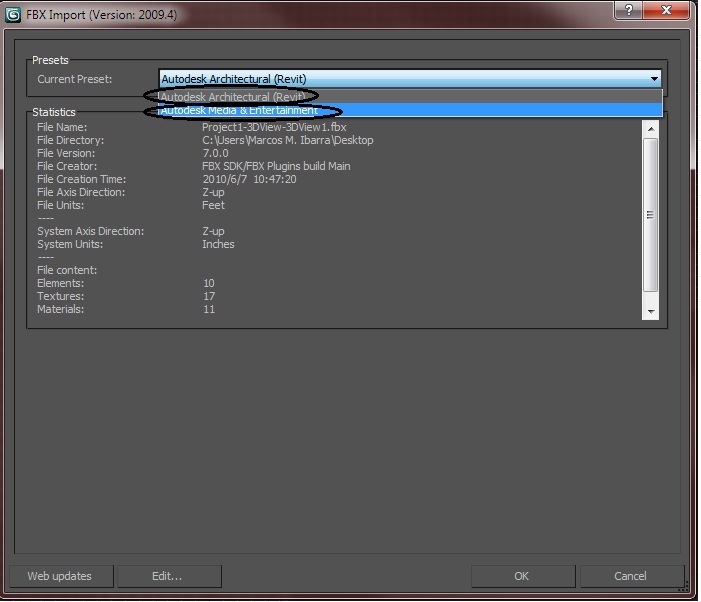

BTW i have a registered V-Ray Adv 1.50.SP4 installed..
What should i select next?  Autodesk Architectural (Revit) or Autodesk Media & Entertainment?
Please tell me what's the difference between the two options and what is preferable to select,
Please see image below.
Thank you for any help you can suggest...
Mon, Jun 7, 2010 at 8:36:56 PM | Step by step of exporting revit model to 3dsmax for render (Vray)?
mrbeandiesel
mrbeandiesel Avatar
Joined: Thu, Jan 8, 2009
69 Posts
1.5 Stars: 4 Votes
I already tried the two options but i'm still clueless about which to choose, please guide me until it renders to vray..

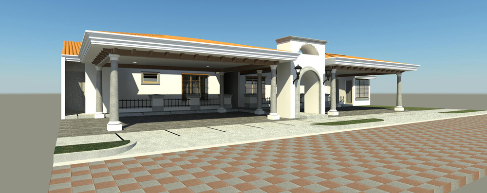

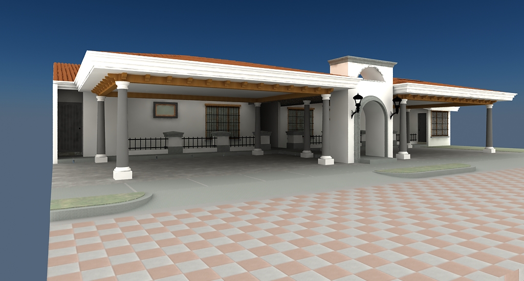

Quoting alabaster2513 from 2010-06-07 19:49:27
Whatchu talkin bout Ernesto!?!?! It uses MR materials and photometric lighting? I abandoned Vray a while ago. you got a trial of SP4?
alabaster, the first image was render in Revit (0:09:36 Medium 300 DPI), the second one is the .fbx file imported into Max 2011 and rendered with VRay 1.5 SP4 (0:01:30 Medium). I just rendered the model (I mean, I didn't apply new materials on it). Well, as you can see the only material that is not compatible is the glass, but in anyway........and yes, the lighting fixtures imported, work as well....
