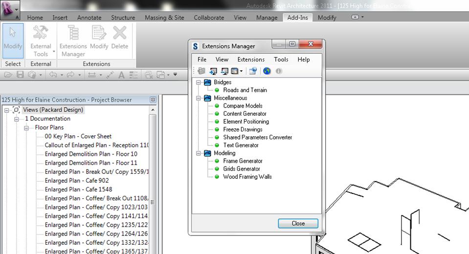

I am in Revit Architecture 2011 and cannot even find "tools", "add-ins", or "external tools".  Am I missing a toolbar? So confused...
Thu, May 17, 2012 at 1:19:25 PM | When you attempt to use the Navisworks exporter in Revit, a “localization” error
IF YOU HAVE NO INSTALLED ADD-ONS, THEN YOU WILL NOT HAVE THE TOO ON YOUR TOOLBAR.
SORRY FOR CAPS - WORKING
Fri, May 18, 2012 at 6:53:59 AM | When you attempt to use the Navisworks exporter in Revit, a “localization” error
Allison
Joined: Thu, Nov 10, 2005
2 Posts
Thanks! I installed the add-ons tab, and now have the 'external tools' button.  Still not seeing anything that offers to 'export' or anything about Navisworks.  Only thing I am able to click is "revit extensions manager'.
