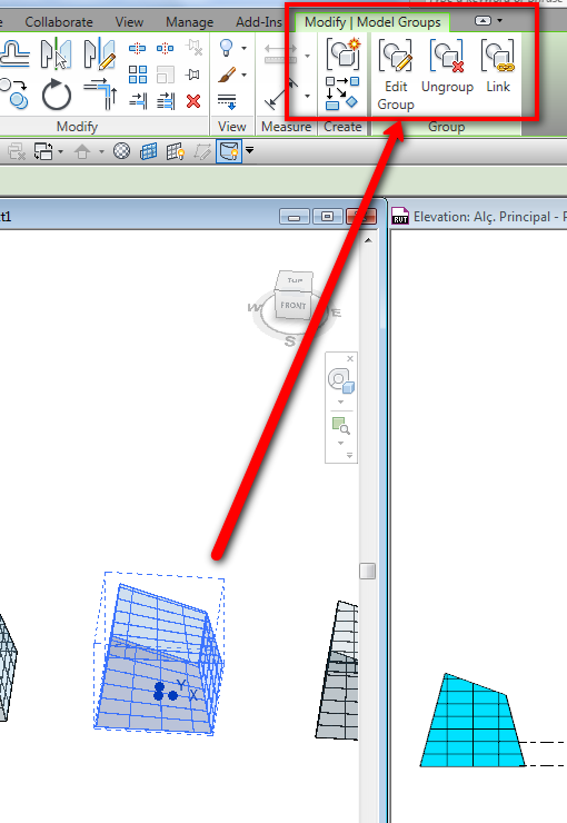

No, that is not the panel I'm missing. I can open a group after I selected it.
 This is the panel i'm missing. (I took this picture in the help files because i can't see it anymore in revit)
Why is it gone and how can i get it to reappear?

Are you using dual screens? watch this: http://forums.augi.com/showthread.php?t=117735&highlight=group+buttons&page=2

Yes, i am using dual screens so that must be it. But this didn't happen in 2010 so i think it is a bug that started with revit 2011.
For now the panel has returned. Opening a group in a family and not in a project got it back. If it gets lost again, i'll try the tips in the link you gave me.
thanks
