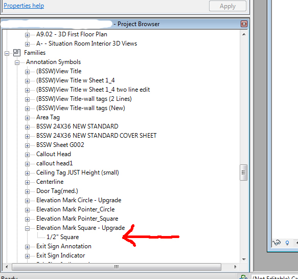

On the left hand side in the Project Browser, below where your Sheets are is a pop down for "Families", you can find and edit the Elevation Tag here.

I overlooked the location of the family. In the C drive (or which ever drive the software was installed to) in the imperial library folder under annotations is the elevation families. In order to edit the text type you have to edit and resave the "Elevation Mark Body_Circle file". In order to change the text for the Elevation mark pointer just click on it while in the family editor and click edit family and change its type properties to whichever font and size. Once all this is done load your elevation tag into your project and as bryanmmiller has pointed out you need to navigate to the project browser and make the changes necessary to get this to display as you wish.
Its a bit confusing but first you edit the "elevation mark pointers" as you wish by choosing one, then clicking the type properties button on the modify tab. Then look for the new elevation tag family you just created select one of the types and edit its type properties to select one of the "elevation mark pointers."  Then go to the manage tab--> additional settings--> elevation tags and select which type you'l like to modify (1/2" square or circle) then select from the drop down list one of the elevation tags you'd like to use.
