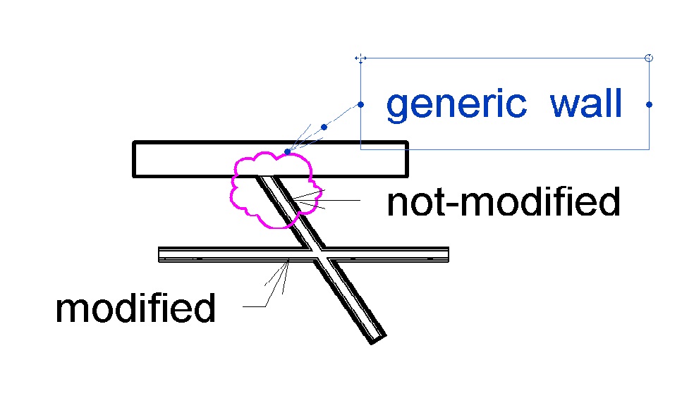

hello,
i noticed that when i draw a partition wall it appears with the same line weight as generic wall. sometimes this good be annoying, having in mind that a partition wall has sometimes more layers then a normal wall, and when you are analising a floor plan sheet then the partition wall have a thicker cutline pattern then normal walls. i wander if it's possible to set up a lineweight in the begining phaze of a projekt so i won't have to change the lineweight using the modifier each time i draw a partition wall.
regards
Wed, Jun 2, 2010 at 7:25:37 AM | floor plan apearence for partition wall
You wrote: "... the partition wall have a thicker cutline pattern then normal walls...".  This is not true.  The line weight for the exterior cut line of all walls is the same and is set in the object styles.  This is not variable by wall type.
In small scale views, if you use settings other than coarse, you run the risk of the lines of multiple wall layers merging to create what appears to be one line.
In pixalated views, some lineweights may appear heavier or finer depending on your printer.  We have worked with our out-sourced printer to correct this issue.
