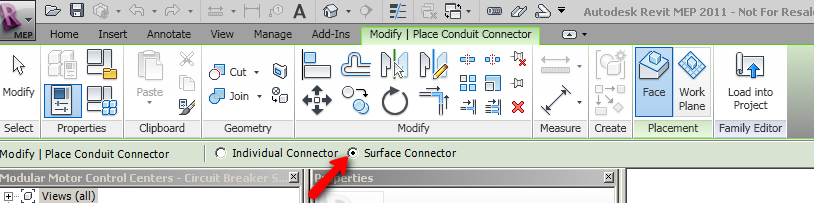

I ran into the same problem using my upgraded 2010 Template. For the Conduit to be able to connect to a Surface, the content has to have a Surface Connector placed on the face. What you will have to do is Edit the family, place a Conduit connector, then select the Surface Connector.  Place that on the face you want to connect the conduit to, then you should be able to attach the Conduit to that face.

look this over, it really helped. but if you open your electrical equipment in the family editor you can place a conduit connector on it in 2011 after you have upgraded your project. make sure you check the surface connector and not just the single connector, unless you have a specific location you want it to connect. like NATEO said.
