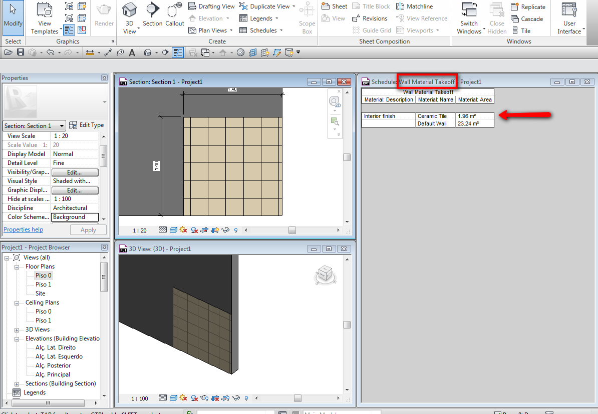

Hi guys and girls,
 I dont know how to calculate an area of wall tiles in bathroom for my project. How do you do it ? I couldnt find any tutorials on how do I calculate a wall tiles area in a bathroom.
 Can someone pro here can help me??
Thanks in advanced!

Look at the bottom of this page, you will see similar threads about this some issue and if this is not what you need go to Forums and search by "Wall Area"...
Watch this thread: http://www.revitcity.com/forums.php?action=viewthread&thread_id=16095
"Material Takeoff", watch the image...
