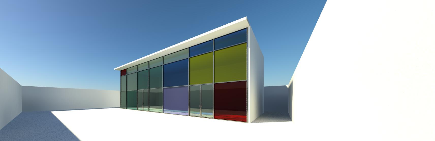

"I'm trying to have colored, clear, and translucent glass in one curtain wall.
I've tried selecting just the panel, unlocked it, and duplicated the type to the glazing i want, but it didn't work."
 Don't really know if this is what you want (see image), but you have to duplicate the material (glass) as well......
