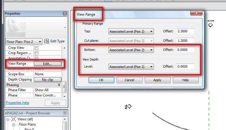

Can someone explain to me how to turn off levels below the one that is current in my sheet views. I'm looking at the secound floor plan and can not get rid of the 1st floor below it. It is kind of confusing.

In that view, type VP (view properties) then in "View Range" check the "Bottom and View Depth"...

if you have the underlay option on, you will have to go to that view and in the view proprties set the underlay to none

Thanks for your responce once again. I have set the view range up higher but it did not resolve the issue. I noticed in a 3D that the walls extend up and slope with the rafters. This is the reason they have not completely disappeared. In the second FP that i'm trying to get rid of the underlayment the only walls still show ing are the ones that are on the 1st floor closer to the ridge (the center of the house) which is were the walls would be the highest point. I have tried setting the top constraint of the walls to the second floor but I did not get the walls to edit at all. Is it due to there not being a floor system above the 1st floor are should the wall stop at the level anyhow.

It sounds like you attached the walls to the roof. Select the walls and detach them.
