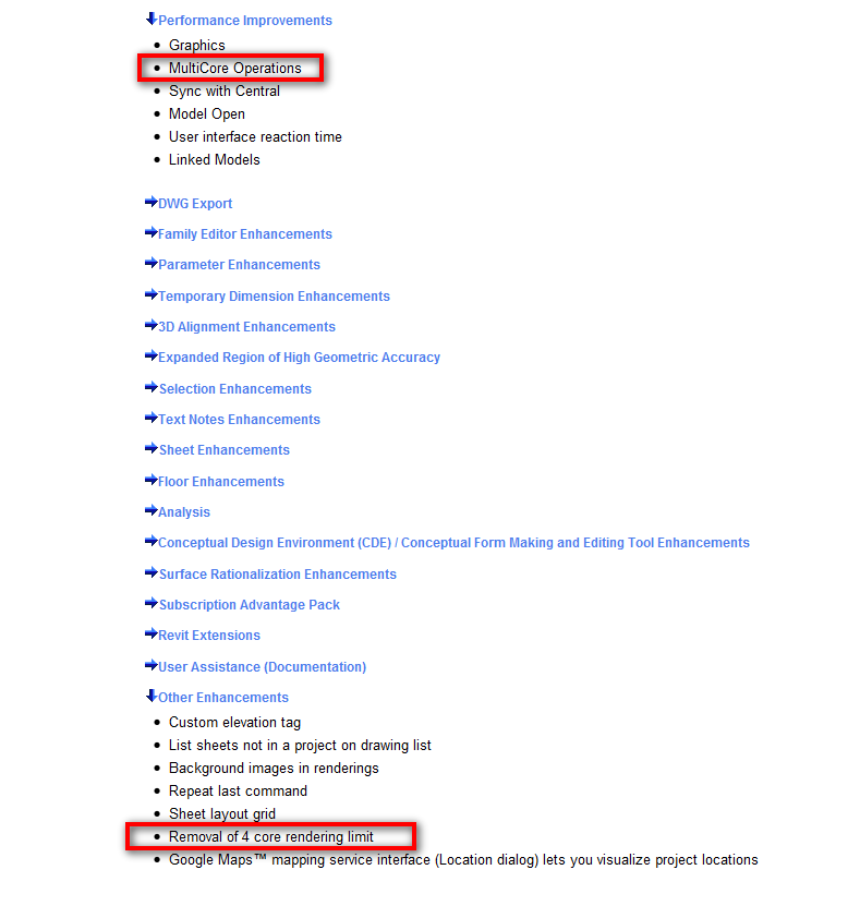

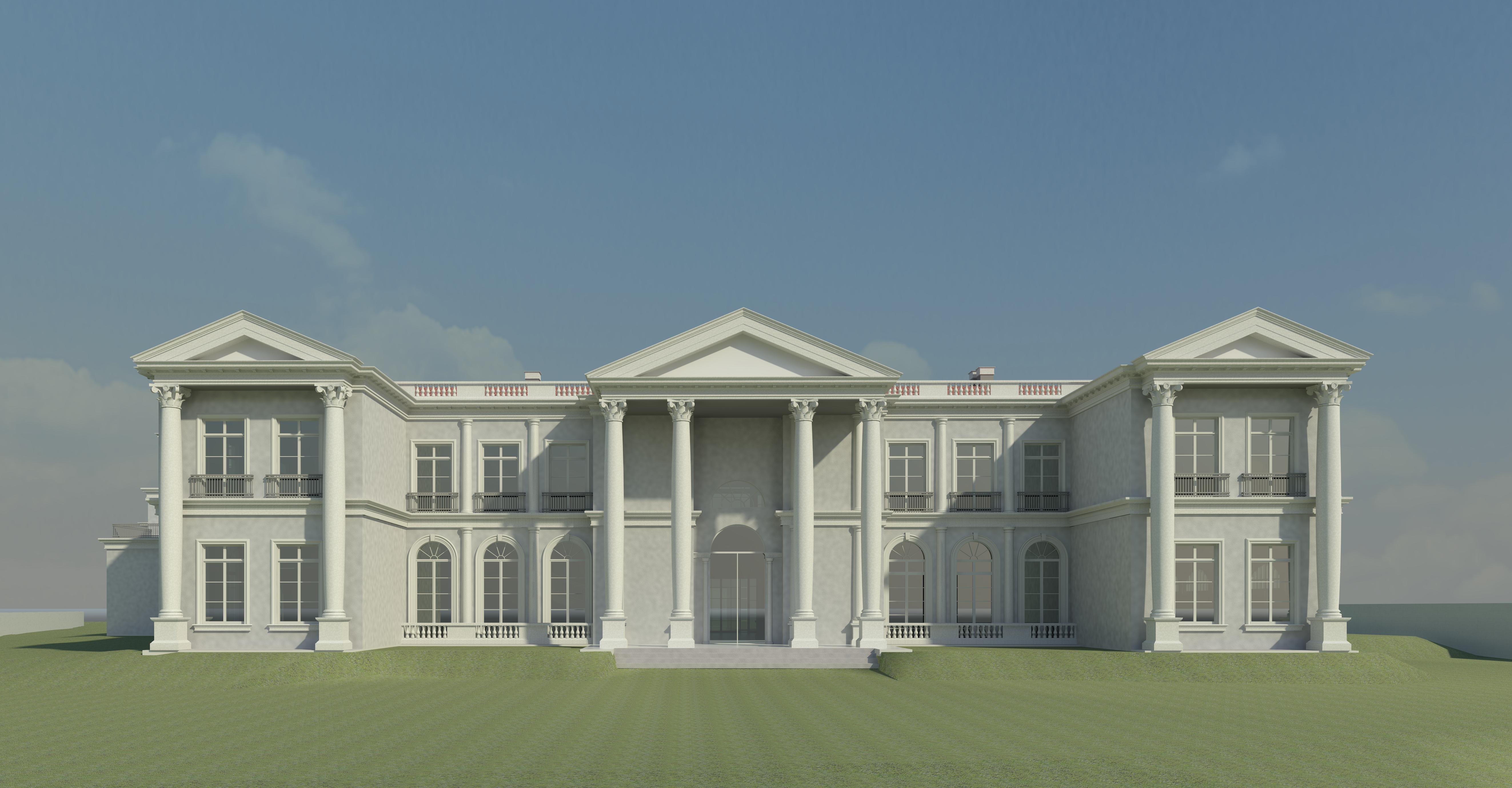

In 2011 Revit mental ray utilizes more cores and nnow uses an autodesk shared library with .png images which render faster. Now when you export to 3ds Max with FBX you can LINK instead of import. I rendered this image at 600 dpi using the settings "best" in 25 minutes in Revit 2011 on a dual xeon quadcore workstation. not bad if you ask me, i believe for me, being fluent in 3ds Max.... interior renders in Revit are still a huge waste of time.

"In 2011 Revit mental ray utilizes more cores and nnow uses an autodesk shared library with .png images which render faster."   -  YES, that's true but still don't render faster than other softwares, maybe next version... I HOPE.
