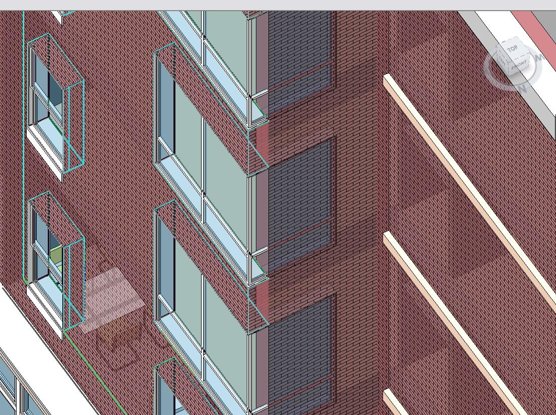

So I'm creating a corner window and I'm wondering how to make a cut on the wall that's not hosting the window.  I know that in the Imperial Library, there is already a fixed corner window and it seems like they're useing voids to cut the wall, so it is possible but I can't seem to figure it out.  Any suggestions would be helpful!

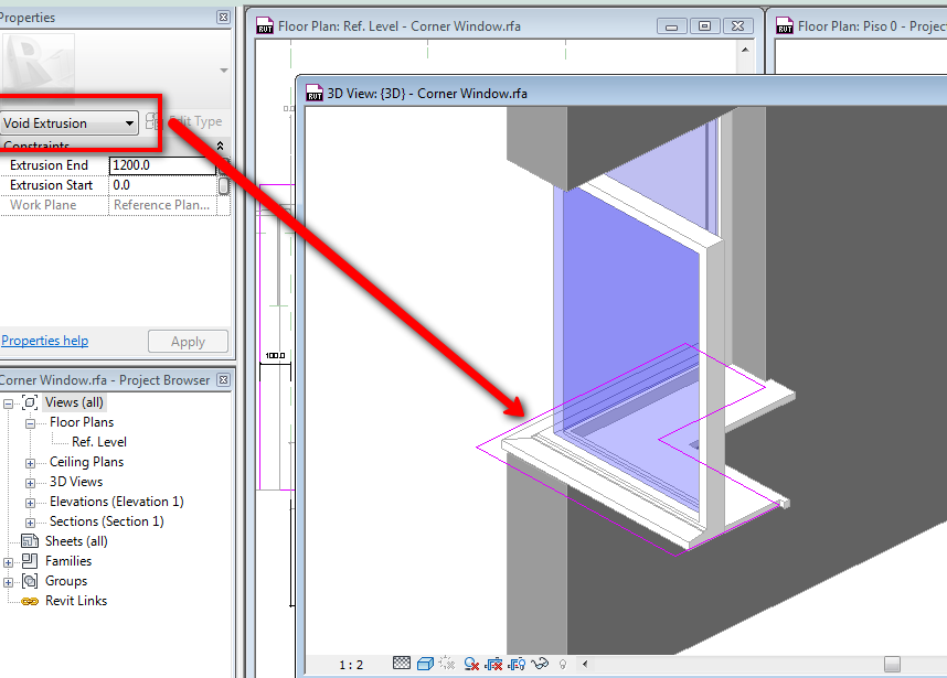

"I'm wondering how to make a cut on the wall that's not hosting the window." Use the create In-Place in Category "Walls" then create the "Void" and use the "Cut Geometry" tool, click on Void then click on wall.

Are you talking about in the project or in the family itself?  I want to make the change in the family so it would ripple throughout the project.  Or is the only way to manually create the void in every non-hosted wall for the window?

What I told you was in Project BUT if you want in family create the "VOID" like the example i attach
