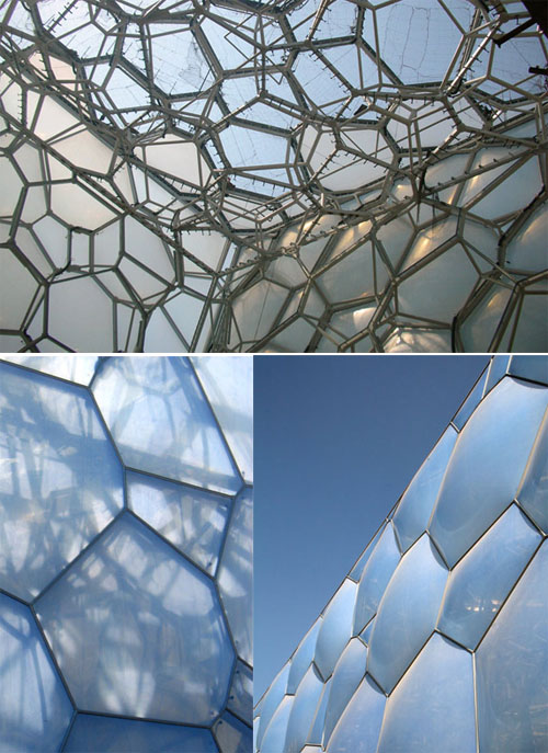

Hi,
Yeh I have attached some images, they are like blown up membranes to make air pockets within a specified frame, the frame can be any closed shape. I attached a image and a section aswell to get an idea.
Although i am not looking to create such a complicated shape,i am looking to use a basic parametric square frame.
