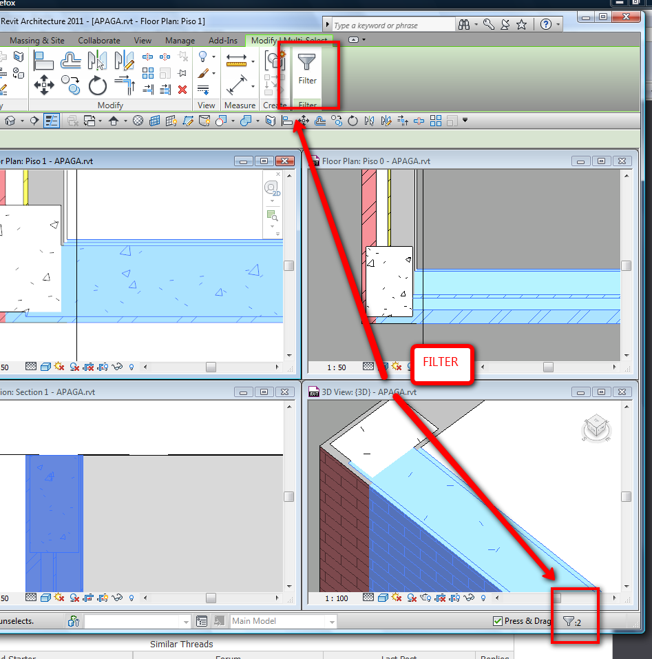

In that 2nd floor select that zone by "Crossing" then go to "Filter" and leave "ON" ONLY that family you want, then delete...

I'm soory but I'm not sure what you mean by crossing. Do you mean window around it , if so I tried it but did not find the filter command. Maybe I was on the wrong tab. Please give me some detail. I appreciate all of your help.

From your HELP (I added comments in BOLD):  Selecting Multiple Elements
To select more than one element, use one of the following methods:•    While pressing CTRL, click each of the elements. •    Draw a selection box by placing the cursor on one side of the elements to be selected and dragging it diagonally to form a rectangular boundary.
<THIS IS A WINDOW>
o    To select only elements that are completely within the boundary of the selection box, drag the cursor from left to right.
<THIS IS A CROSSING>
o    To select any elements that are wholly or partially within the boundary of the selection box, drag the cursor from right to left.
•    Press TAB to highlight connected elements, and then click to select. See Selecting Chains of Walls and Lines. •    Right-click on a family type name in the Project Browser or a family type in the drawing area, and click Select All Instances. This tool selects all instances of that family type in your project. See Project Browser. NoteIf you are editing a design option, the tool name is Select All Instances in Active Option. It selects all elements of that type in the active option only.

Just to show you where is the "Filter" tool.... WW said the rest...
