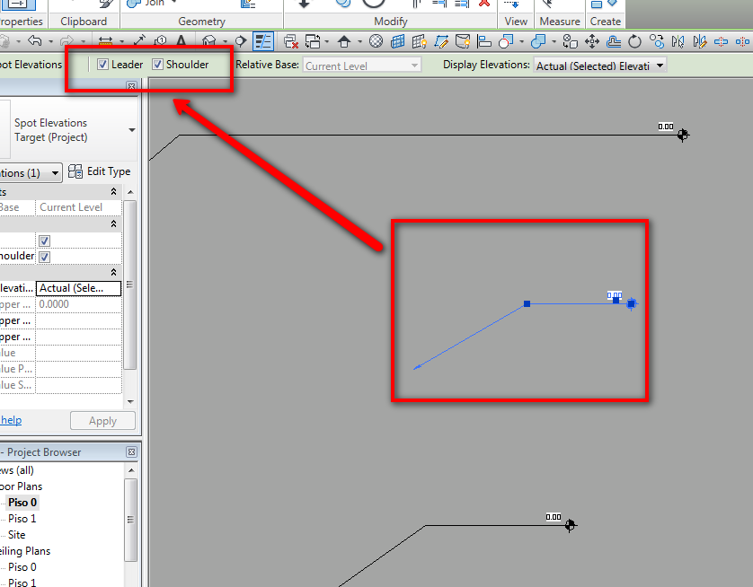

When you click on spot elevation you will see in option bar "Leader"

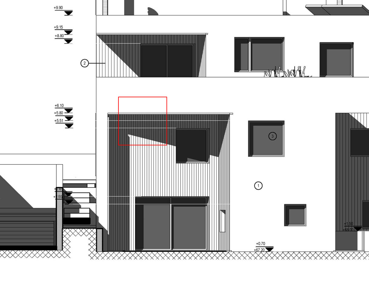

I am sorry about that,
here's a capture.
I've turned the leader lines in White color to be as hidden as possible,
but when I export they are still visivle over a dark background
I just need them to be completely hidden
thanks again!

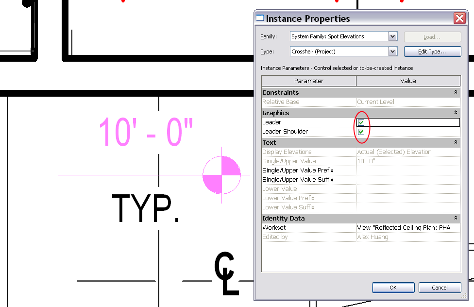

leotrans, yuor elevation looks great, it's quite simple to turn the leader off, see instant property, uncheck leader or shoulder.
Edited on: Wed, May 19, 2010 at 2:37:48 PM
Wed, May 19, 2010 at 2:52:59 PM | Hide Spot Elevation Leader
leotrans
Joined: Tue, Dec 8, 2009
6 Posts
thanks,
I tried that, and the moment I uncheck the box the spot elevation moves to the location where the leader
starts.
I was wondering if it is possible to keep it outside the elevation edges but without the leader line
One way maybe it to use reference planes.. but then it needs too many.
thanks again!
