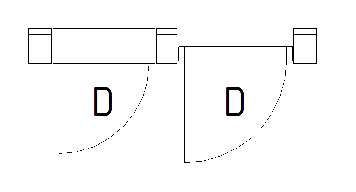

So I've been creating a custom library with parts for a template, and I've used the doors that come with Revit and made smaller changes.
 The issue I've got is that the "indoor-doors" auto adjusts their frame-depth to the walls depth, even if there is a "Frame-depth" dimension type. It looks kinda silly with a 300mm Door-frame.
Anyone know if this is easily changed? Because the "outdoor-doors" have a settable and working door-frame depth parameter.
 edit: You could watch the image for an overview. (Left inner door, right outer door)
Edited on: Tue, May 18, 2010 at 3:03:43 AM
Tue, May 18, 2010 at 6:51:17 AM | Door-frame auto adjusts?!!
This is because this is the way the family is built.  If you want the "indoor" door to have a controllable frame depth, you will have to modify it.  Use the other door as an example, or use that door and modify it to create your interior doors.
