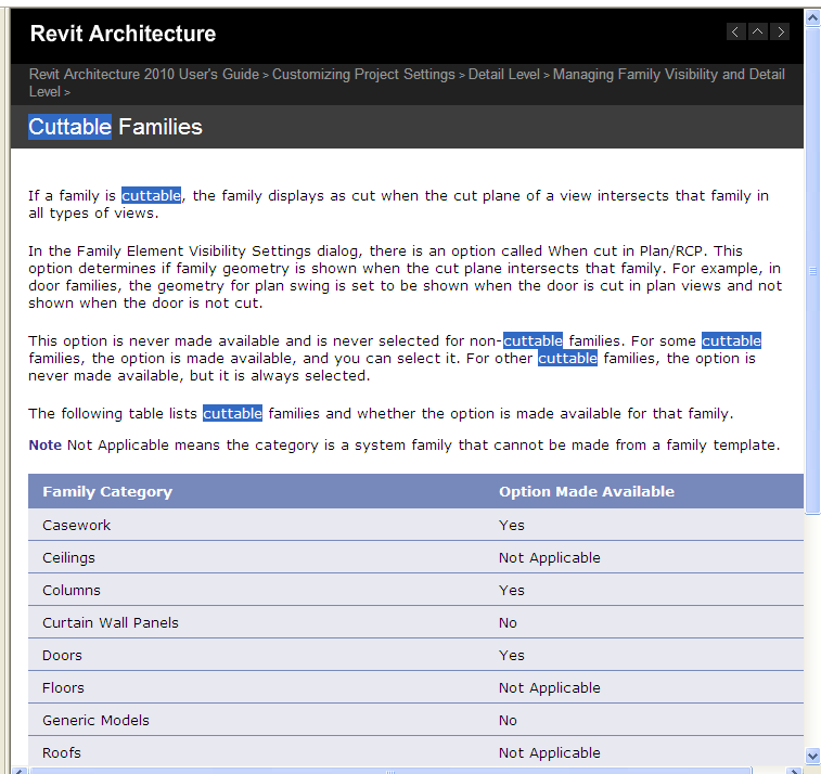

What Help file are you looking at?  See attached.
"...The problem is that it doesn't fill the section with the assigned hatches ..."  I don't know how you can assign a hatch to a cut import.  Can't be done.  You can assign render materials to the faces of imports.  If you want cut hatches, you have to add them.

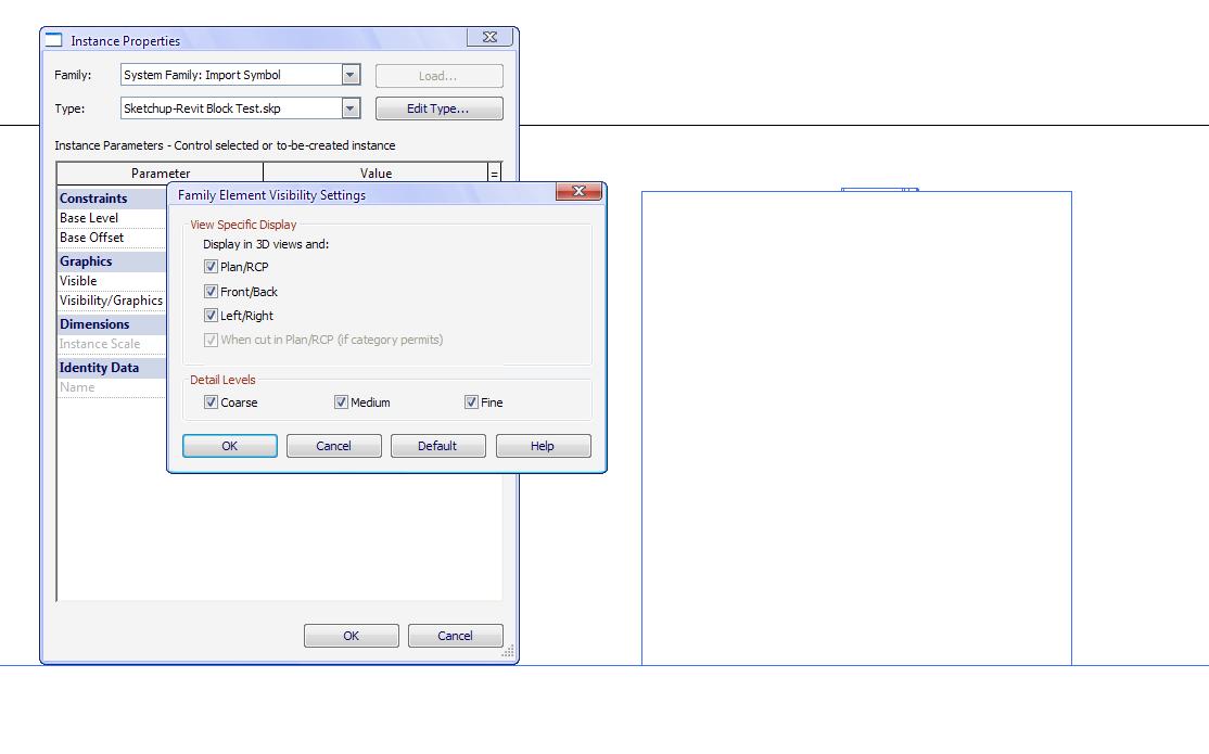

"...  the 'When cut in Plan/RCP' option in Visibility/Graphic Overrides is checked for the object regardless of the (cuttable) family type it was imported in..."  Nope - Not true - See Second image.  This skp file is in a cuttable family and the box is not checked!  But that still doesn't mean it will cut correctly.

See the attached image: what you're looking at there is a basic test block I imported from SketchUp and my Graphics/Visibility options options. The testmodel was imported into a 'Generic Model' family.

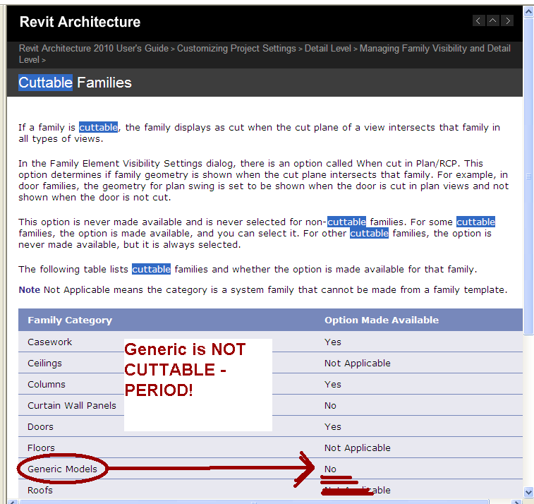

MY FAMILY IS NOT A GENERIC FAMILY - IT WAS CASEWORK because that is CUTTABLE.
You did not read that chart correctly.  See attached
Material assignments for imported objects are faces... not cut. If you want cut hatches, add 2D fills / linework and turn off import.....

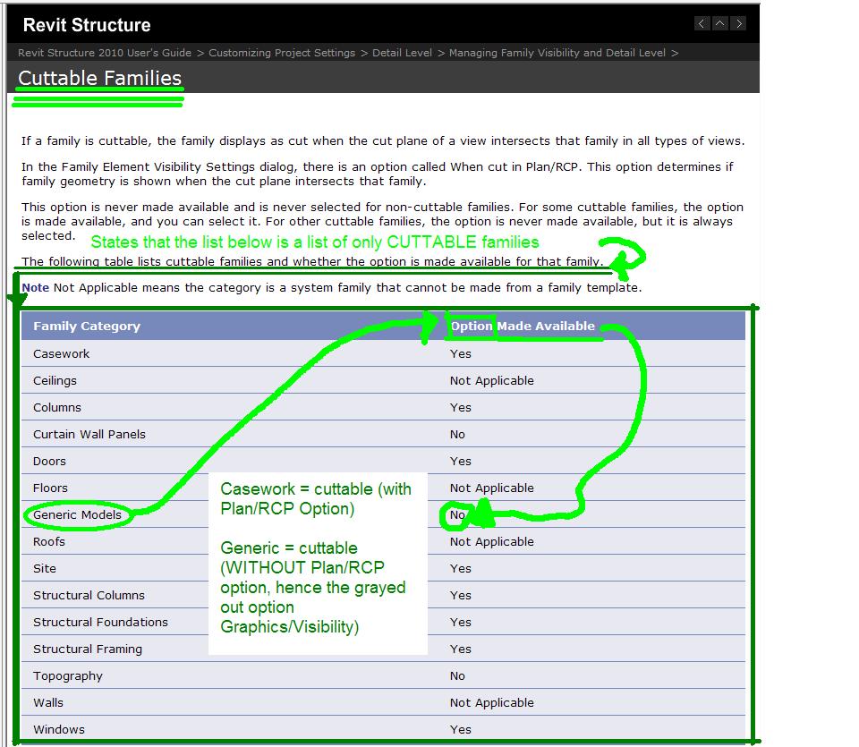

"MY FAMILY IS NOT A GENERIC FAMILY - IT WAS CASEWORK because that is CUTTABLE." - wow, I never said yours was generic. Mine is, since that is what I read to be one of the recommended family types for import. And I hate to say it but you have completely misread the help article. See attached image: BOTH generic AND casework are cuttable! The difference is that generic models are not provided with the OPTION TO TURN PLAN/RCP ON OR OFF. Help includes a seperate article about NON Cuttable families where those are listed.
I tried importing into a CASEWORK family template with worse results actually. The strange thing is that when importing Sketchup objects in the casework family template (which has the on/off Plan/RCP available, as apose to say generic model family), in the casework family the imported object appears to be completely non cuttable (and has the Plan/RCP option grayed out and unchecked in the Graphics/Visibility options as displayed in one of your previous images)!
"Material assignments for imported objects are faces... not cut." - I'm not sure what you're trying to say, indigenous (form/mass) object consist of faces aswell
