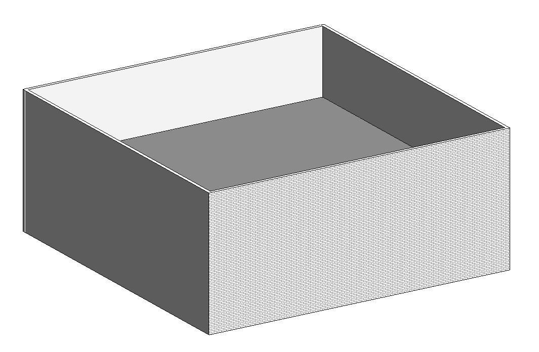

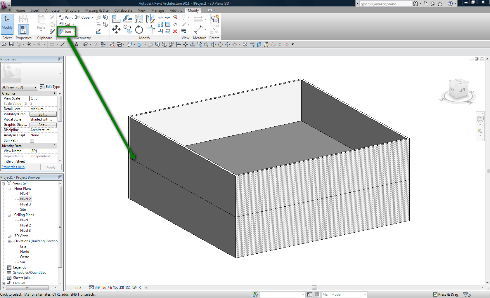

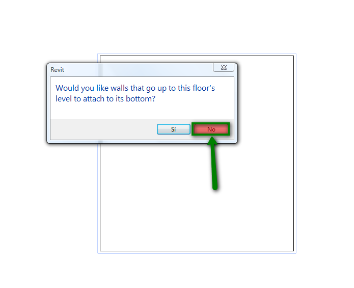

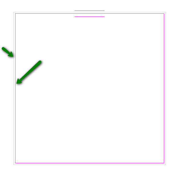

"...is there a way where the walls connect on the outside?"....Try this way ( see images):
76998_2010-05-152103.png76998_2010-05-152103001.png76998_2010-05-152106.png76998_2010-05-152106001.png

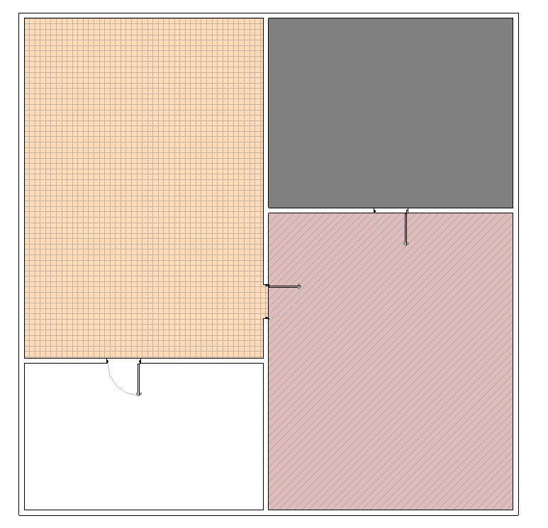

"Also if i want to have different types of color/textured floors in different rooms, do I have to split each room"....Duplicate them so you can apply the colors/textures you want.....
