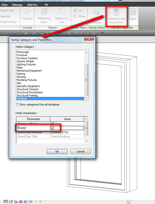

You can nest a window family into another window family but to schedule the windows separatelly, open the nested family, go to Category and parameters and turn ON "Shared"...

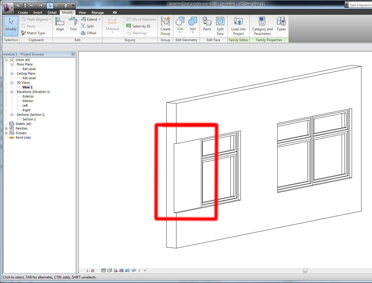

- unfortunatelly I need some cutouts next to the windows - so I created a soild void and joined with wall next to the window - it works when in window family but not when inserted into the model Sad
Could anybody help me ? I attach the family files I used

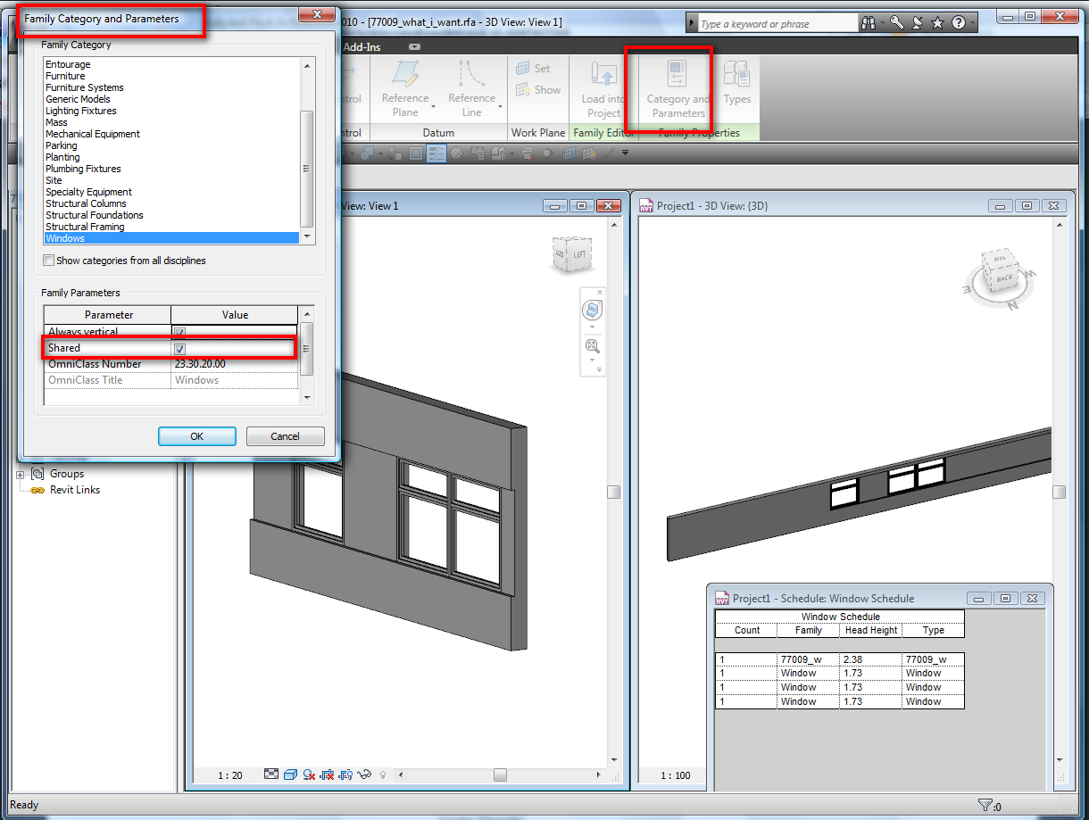

Is this what you want?

I need the window to actually be a separate family within a family - so then I can schedule every window separatelly but to actually insert modules of 3I attached the family I want to insert into walls in main model - it does not work unfortunatelly

To schedule you must turn ON the shared parameter...
