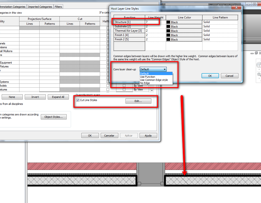

Is there a way to Hid Lines deplicting finishes on walls in plan view to see the core lines only and not change the wall Family/type.  The finishes, of course, are on the outside of the core.
 Thanks
Sat, May 15, 2010 at 5:49:20 AM | Hid Lines deplicting finishes on walls in plan view to see the core lines only
Joined: Tue, May 22, 2007
5921 Posts
4 Stars: 205 Votes
Well, if it is what i am thinking (which is, in plan view you only want to see the CORE of the wall and nothing more) the answer is NO, you can do that if you create several walls with different functions (which is a pain in a heck) then you can hide what you want BUT in VG you have the "Cut Line Styles" where you can change the thickness of the core of the wall...
I hope this can help you..
