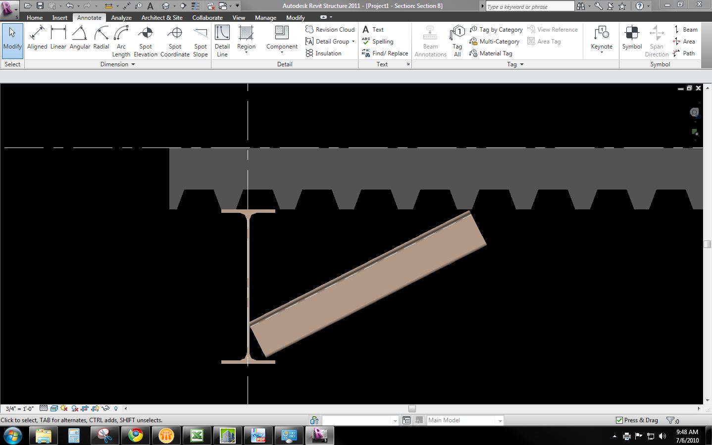

Tue, Jul 6, 2010 at 9:52:35 AM | Structural kickers
NkatOmg2
NkatOmg2 Avatar
Joined: Fri, Jun 18, 2010
26 Posts
4 Stars: 1 Votes
anasmiley:  You can add a kicker.  I attached a picture of one added to my model.  The kicker is a live element.  It looks nice.  However, when detailing kickers in sections, we would always draw them as 2D elements for our structural drawings.  I would recommend that you draw them as 2D elements as popping in 3D kickers is a pain.  If you are wanting to use them as 3D elements for a space and/or interference study then 3D is no problem.
 I use Autodesk Revit Structure 2011
