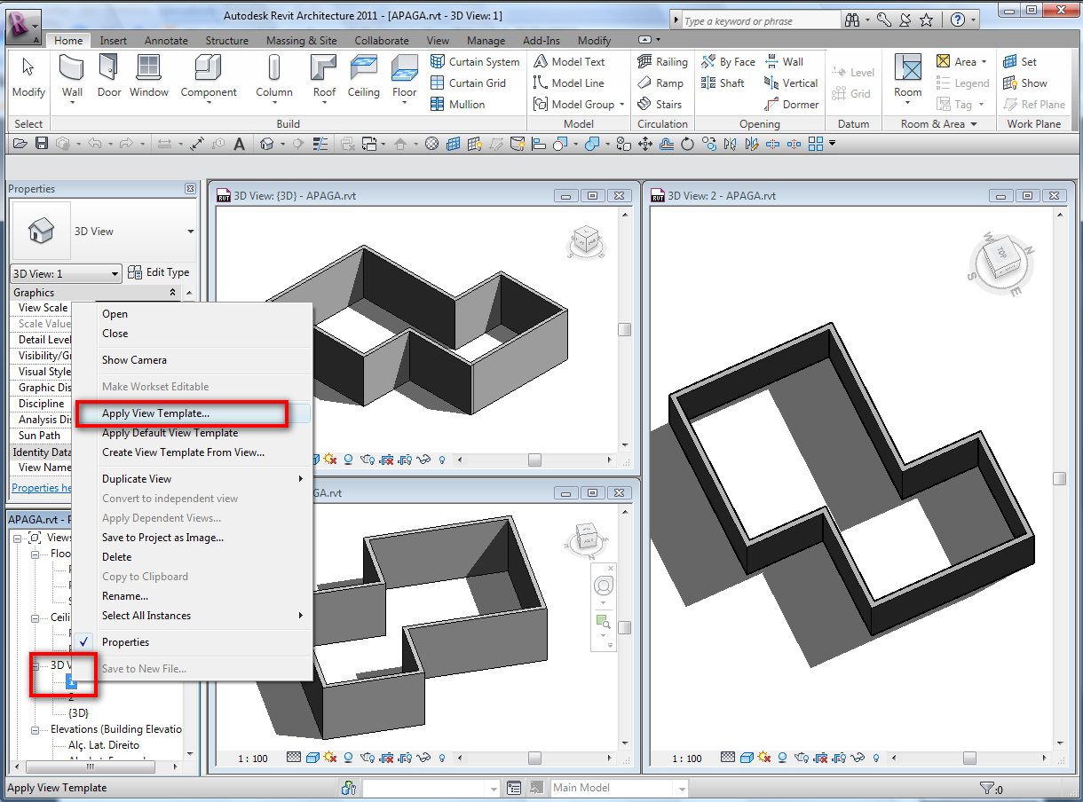

 I have set up some 3d views, (duplicated the standard 3d view then rotated zoomed in etc). When i close down revit and reload the model the views all seem to have reverted back to the standard 3d view. I am assuming you can lock the 3d views but i can't find out how. Any help would be much appreciated.

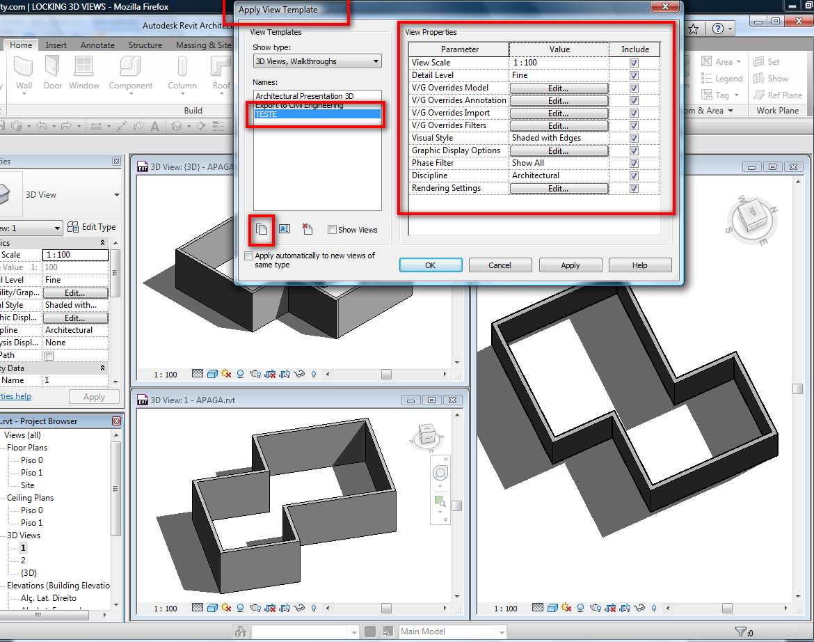

Just duplicate, then in project browser in each view select "Apply View Template", create a new view template, rotate, zoom the views like you want, save and close then open again and check if this is what you need...
