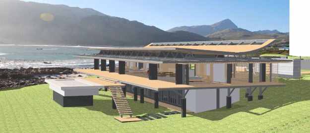

I've just been upgraded to Revit 2010, and getting the hang of the awesome new layout. In Revit 2009, I could render a 3D view with a background jpeg of the site inserted beforehand. See attachment. Worked wonderfully.
2010 doesn't have that function in it's rendering-menu. I searched through Revitcity's forums, and cannot find the question raised here previously. So has the "insert jpeg" been disabled in the newer version? Do I have to insert the image manually with Photoshop? Hopefully not.

"Do I have to insert the image manually with Photoshop? Hopefully not." NO, you don't need PS, what you can do is: Render the image, export the image in a PNG extension, then create a Drafting View and import that PNG render and the JPG image you want to put in background...

Create a massive wall behind your project and Decal the image onto that
Then render away
