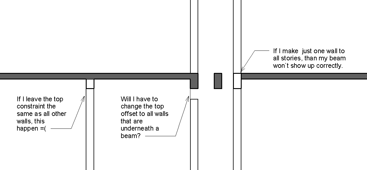

Hello,
I am having some issues regarding the joints of wall + beam + floor in my sections.
Please check the attached section png, it should be clear what is the problem.
3. Any walls that go multiple stories should go multi stories not stop and start at each floor.
I have read this tip in another topic, but maybe that is old now. The problem in doing that is that my sections won't show up as I'd expected them to. I would like to have only my floor+beam joined showing as a single object and the walls NOT going through them.
 I believe that I should model in Revit as it is in the real world, so that would make me make one wall for each level, but then, say I have 100 walls in one floor, only 10 of them will have a different top constraint. Will I have to setup these 10 walls manually?
