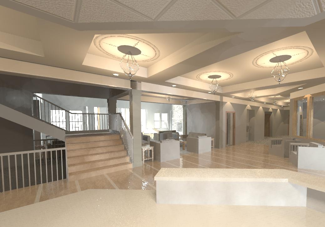

I'm working on rendering the interior and trying to get the lighting to work correctly. I've attached an image for reference...recessed lighting looks good but the pendant lights don't. The light only seems to shine up towards the ceiling, I went into the properties and the light source is set on spherical, which is correct. I changed it to the hemisphere just to see what happens and the light goes away completely. Not sure what's going on. Could anyone help me?

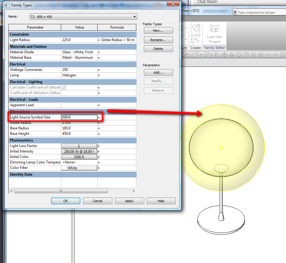

Try to increase the "Light Source Symbol Size"...
