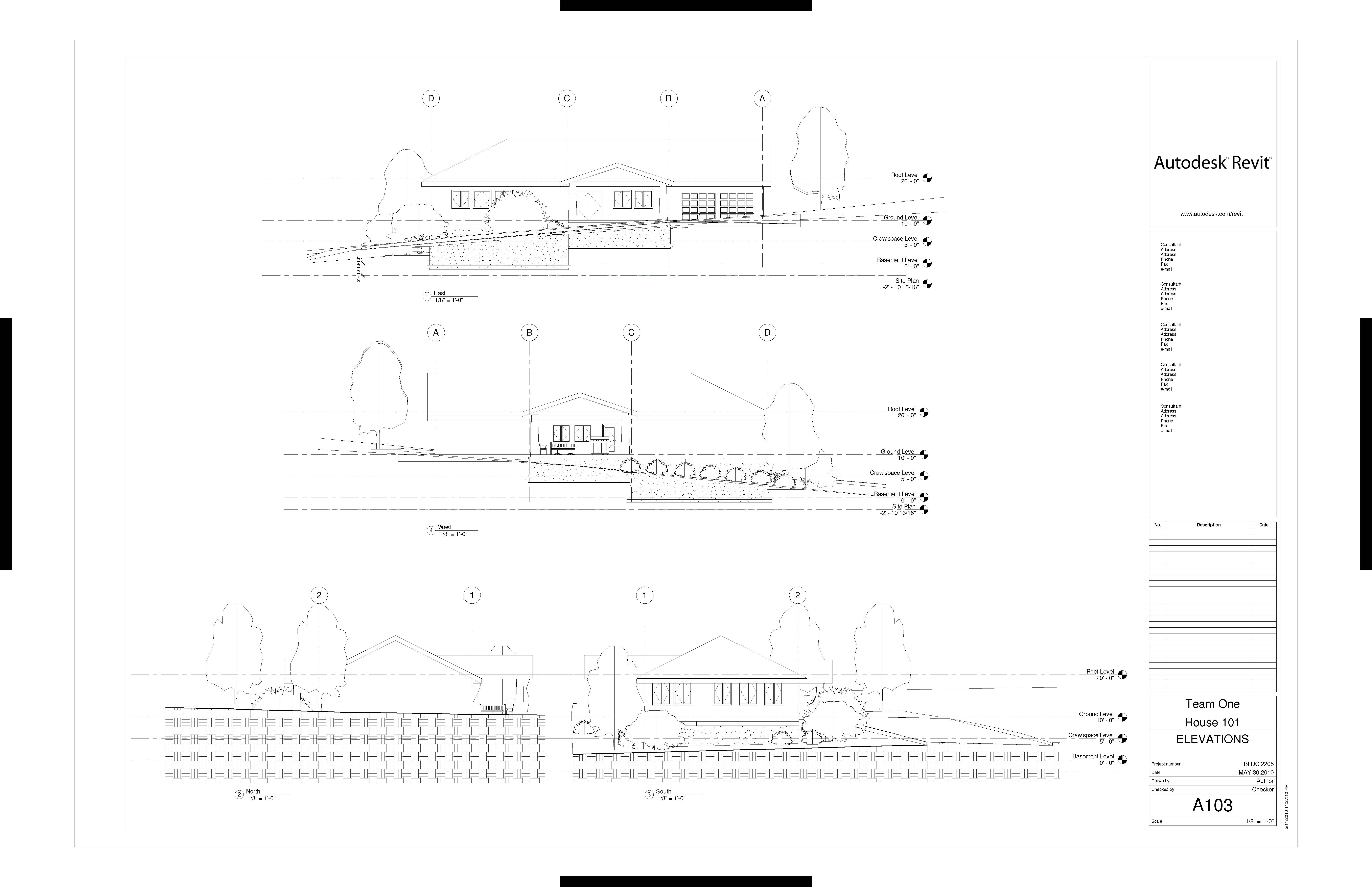

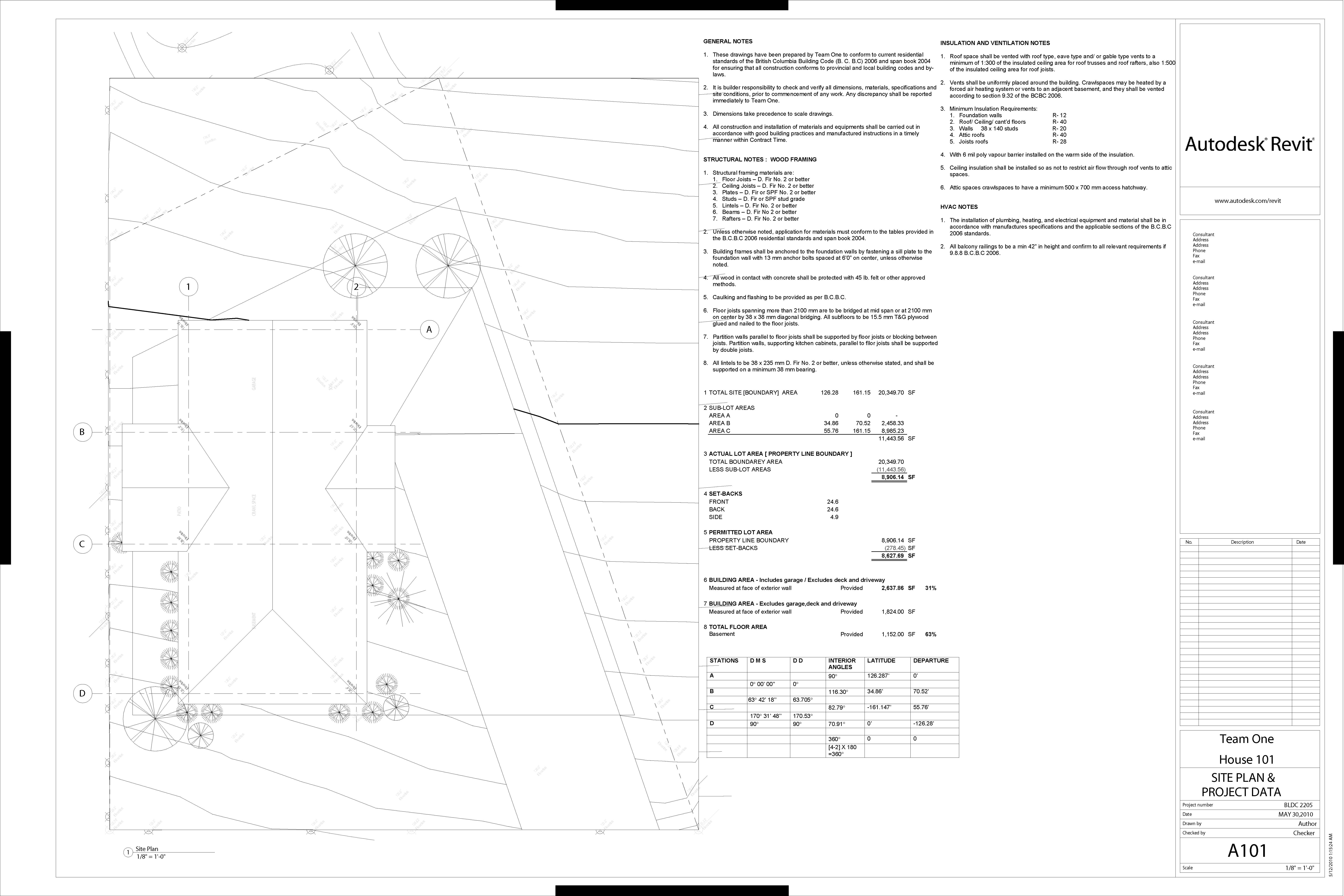

here are some drawings sheet generated. couple of problems still having.
1. topo pad in garage- still saying there is overlap but my section AB is not showing any pad?
2. driveway slope up to garage - how to do that with grade ?
3. how to add override the callout details with 2d details done in cad?

oops here are the drawings...
i did the pad under the garage but my next problem is the driveway to the garage using the pad slope . how can i adjust it on section instead of entering values?

what is the thickness of the pad, you may want to regrade the driveway area then add your driveway slabs.

Thanks. Regrading is where i am struggling with and still searching for video tutorial . do you know where i can  find a good and simple resource to learn that ?
The pad is very thin 'slab' so to cut through the earth. Isnt' that what it does?
