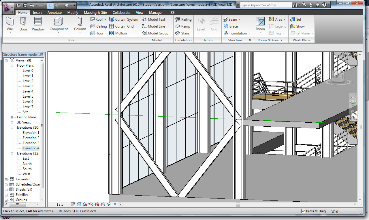

Hi,
I have set up the framing elevations and am currently putting the wind bracing in.

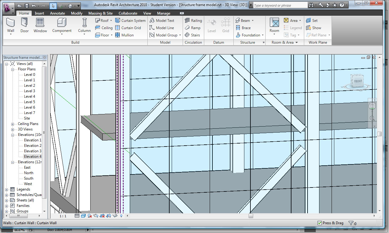

However i am finding it very annoying how the braces are practically floating in mid air/digging through beams depending on the orientation of the columns. Is there a way to fix this so they attach properly?
I have attached images below
Thank you for any help.

Edit the family so at the angle you are placing them, they cut vertically,Then if you set it as your first image beam orientation they'll appear attached
