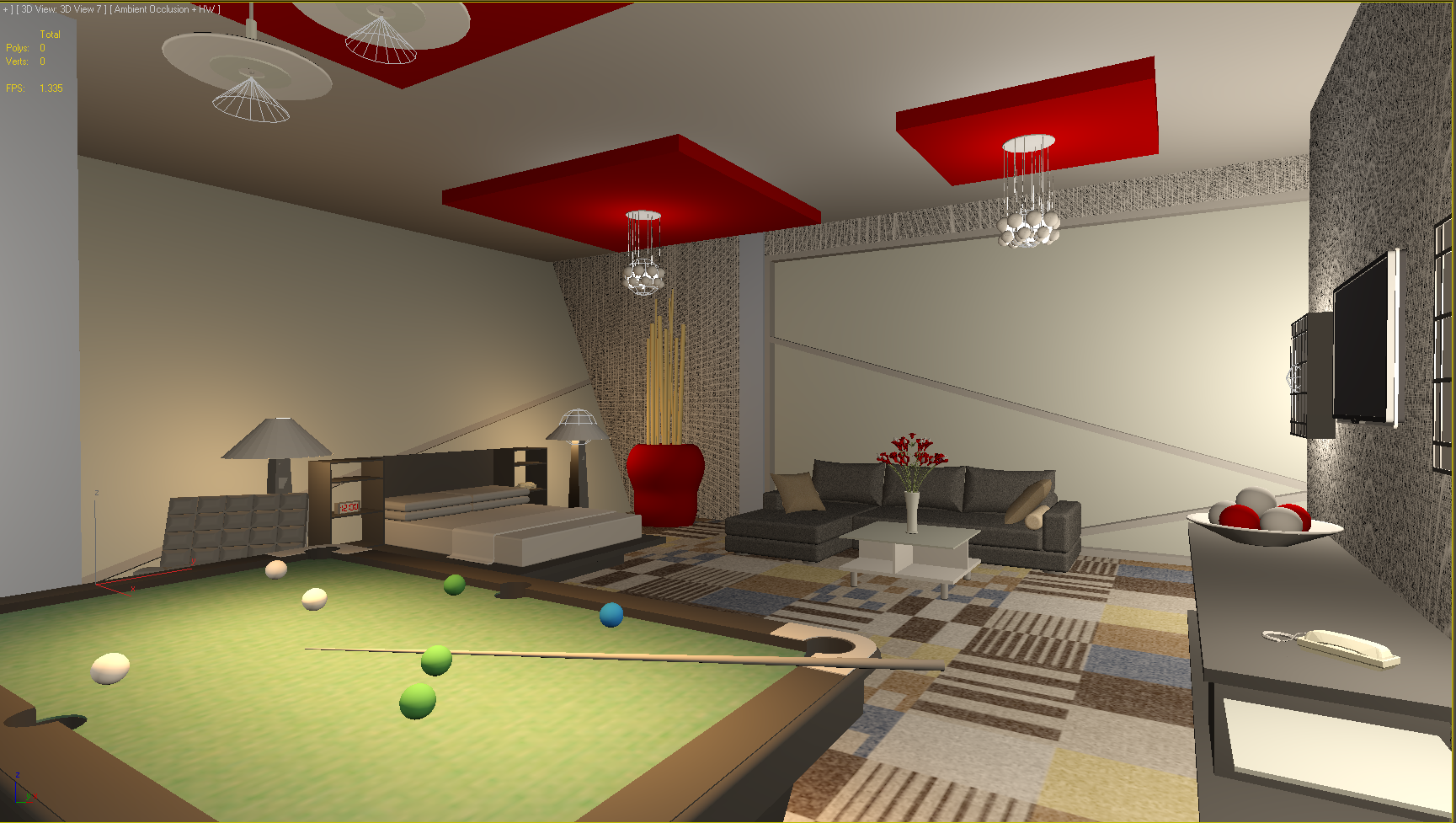

what version are you using? FBX works very easily for me, within minutes I have my scene setup in Max and ready to render. I imported this scene 20 minutes ago and am rendering now.
