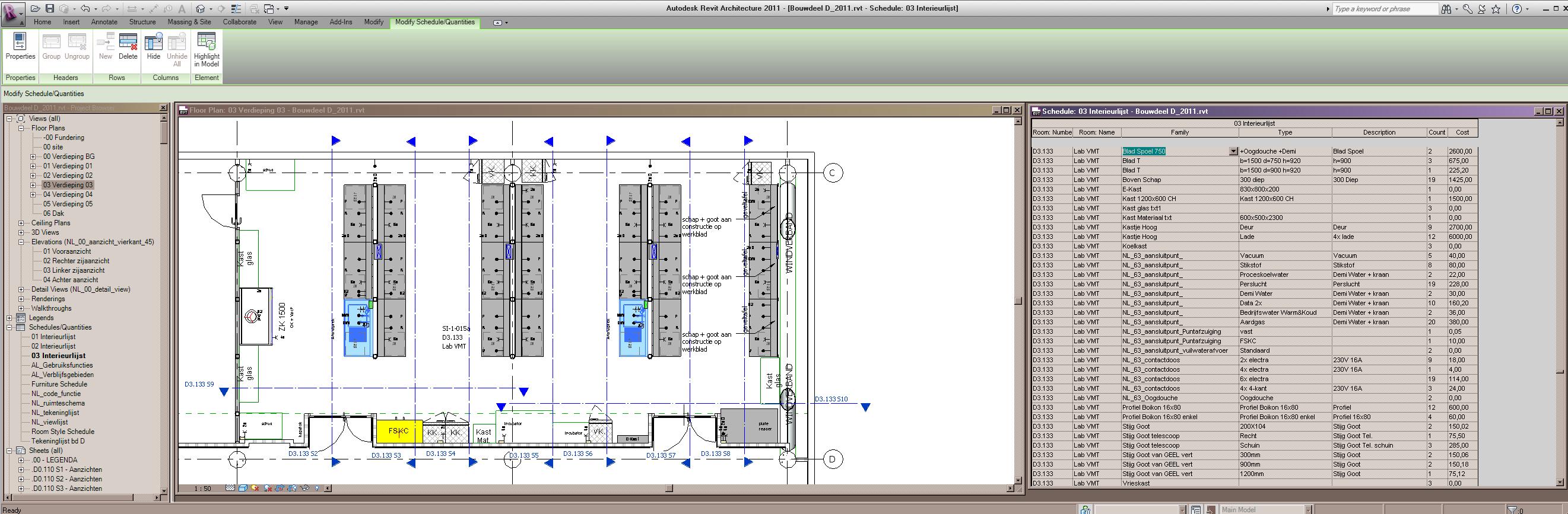

When you're using roomnumbers you can make an interios schedule sorted by room.
So for each room you'll get the interior components wich go in this room (check the image).

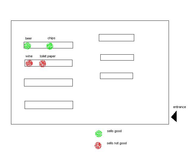

Well, the thing we want to do with it is the following:
We are doing this for a big retail project, with many chain stores. The reason that we want to know the exact location is not for the builders, but for the contractor. In the end he wants to analyse the design of the shop lay out by the amount of sales each month or year. In that way we can check whether it sells better to place the beer next to the chips or something like that.
To do this we need to map the sales in a plan. If we relate a piece of furniture to it's position and to the product that is sold, than we can relate this to the sales results and improve the design of the shops.(see image attached)
The thing is, that we would like to automate this as much as possible, because there are many shops from this client.Is there perhaps a way (out of Revit) to do such things ??
I got one idea thanks to your first reply Gebber:Last night I was thinking the following: What if we would do it in pixel-style? --> make a 1m by 1m (or 10cm by 10 cm) grid of rooms and put this as an under-layer of a drawing. This might lead to a result that is near to a location. Similar as in maps, you'll get D10 as a square where a certain product is. But this is, i know, a bit long-winded. And than I don't know yet how it works when a piece of furniture is spread over 2 or 3 rooms at the same time...Is this in any way a possibility? Or do any of you guys have better ideas (I certainly hope so)??
