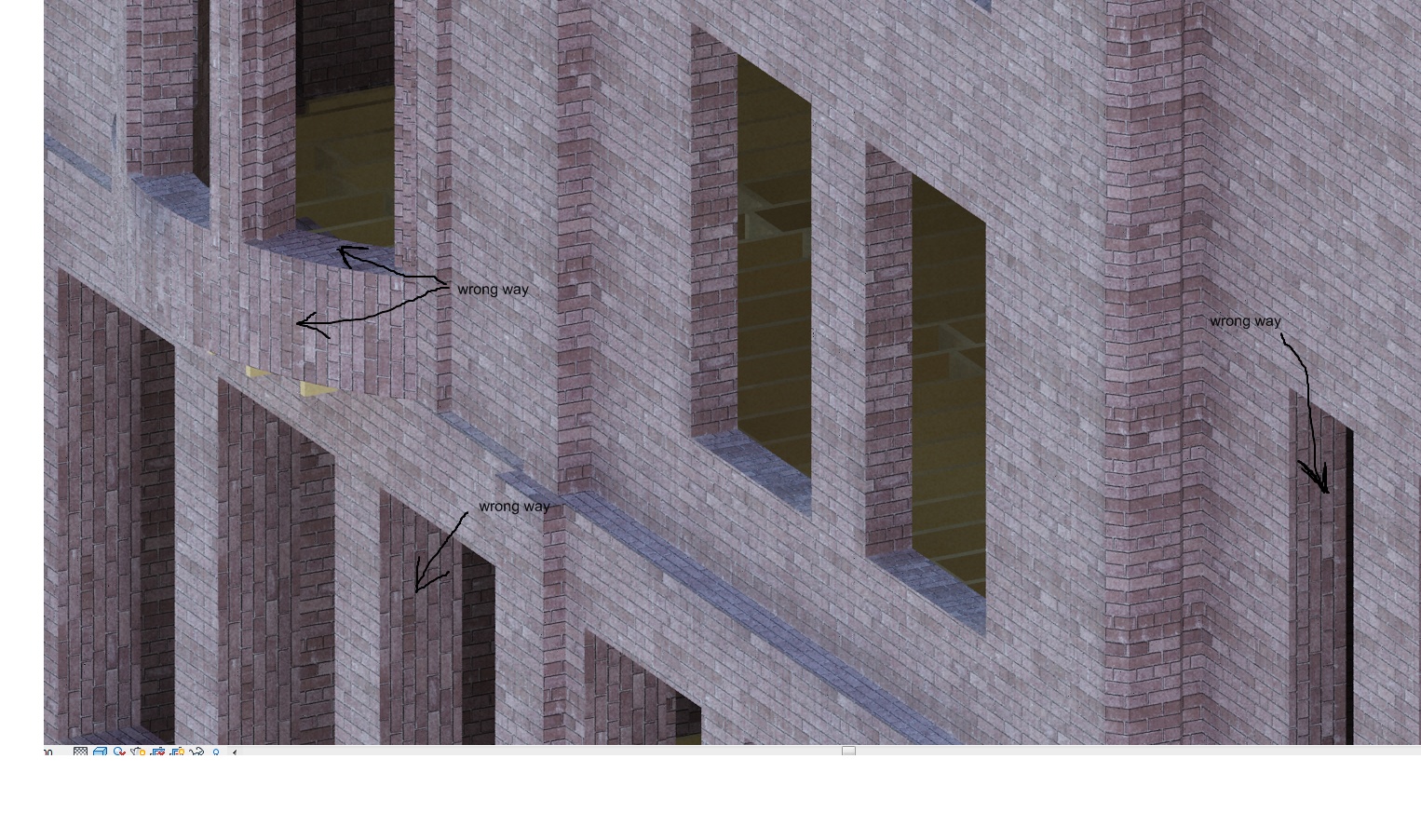

Hello, I am working on a project where i am drawing the existing facade of a building. the inside of the building is being demolished with a new R,C. frame built inside. Anyway I have built a model i am happy with (i used the 'model in place' function to extrude the walls up as they are all pretty irregular. The problem that i am now having is when i render the masonry the rendering program is flipping the brick courses through 90 degress in some locations. I have attached a picture which shows this. Anyone got any ideas how i can force it to render horizontally everywhere?
Thanks for your help

And in the elevation and section views you have the Pattern of the brick rotated too? if so and if that pattern is a "Model Pattern" you can hit in the pattern then rotate the pattern.
Other way is duplicate that material with another name, go to the properties of that new material and rotate the parameter to 90 degrees then use the "Paint" tool with that new brick and apply to those faces...
