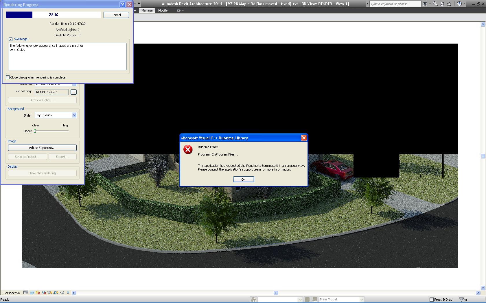

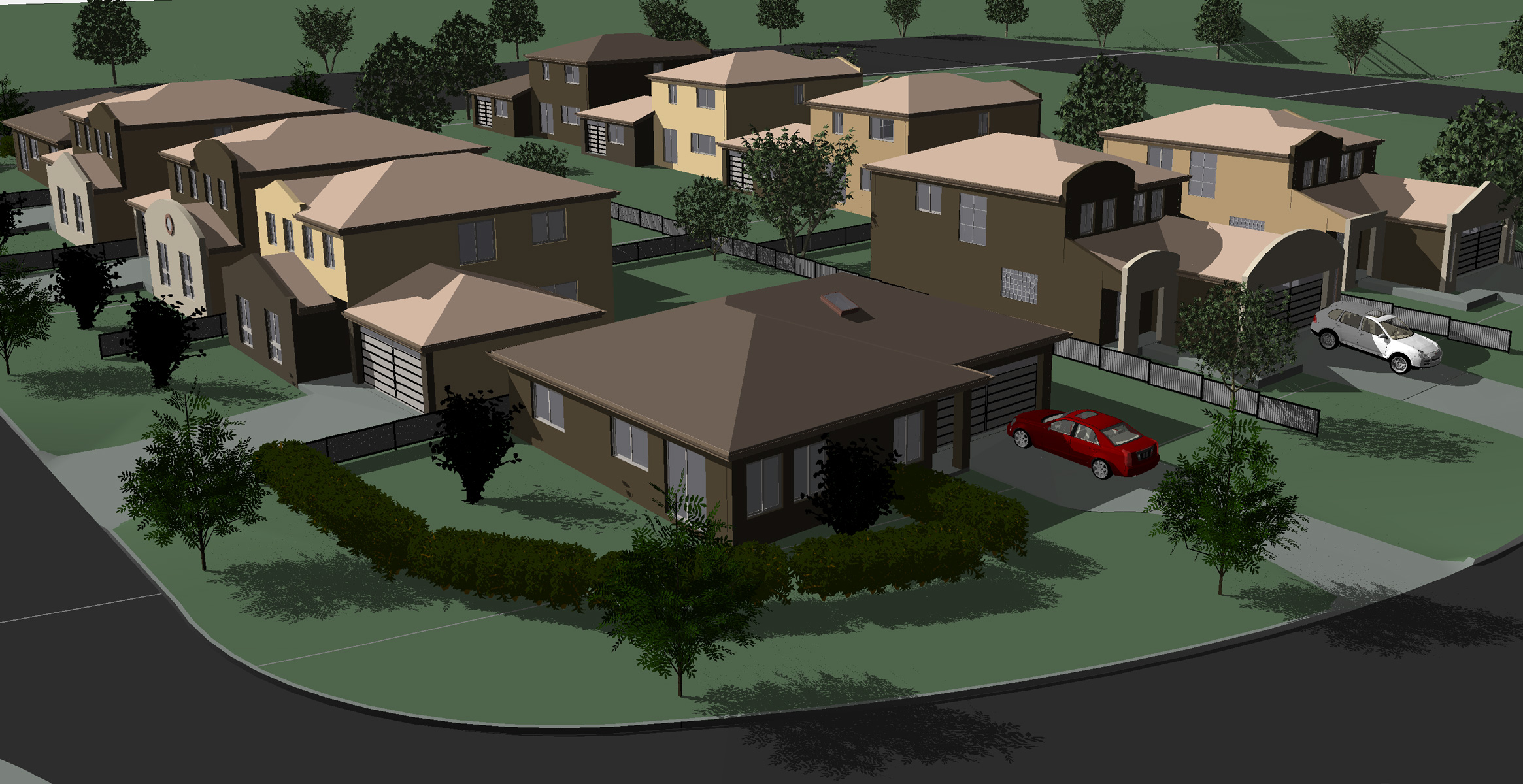

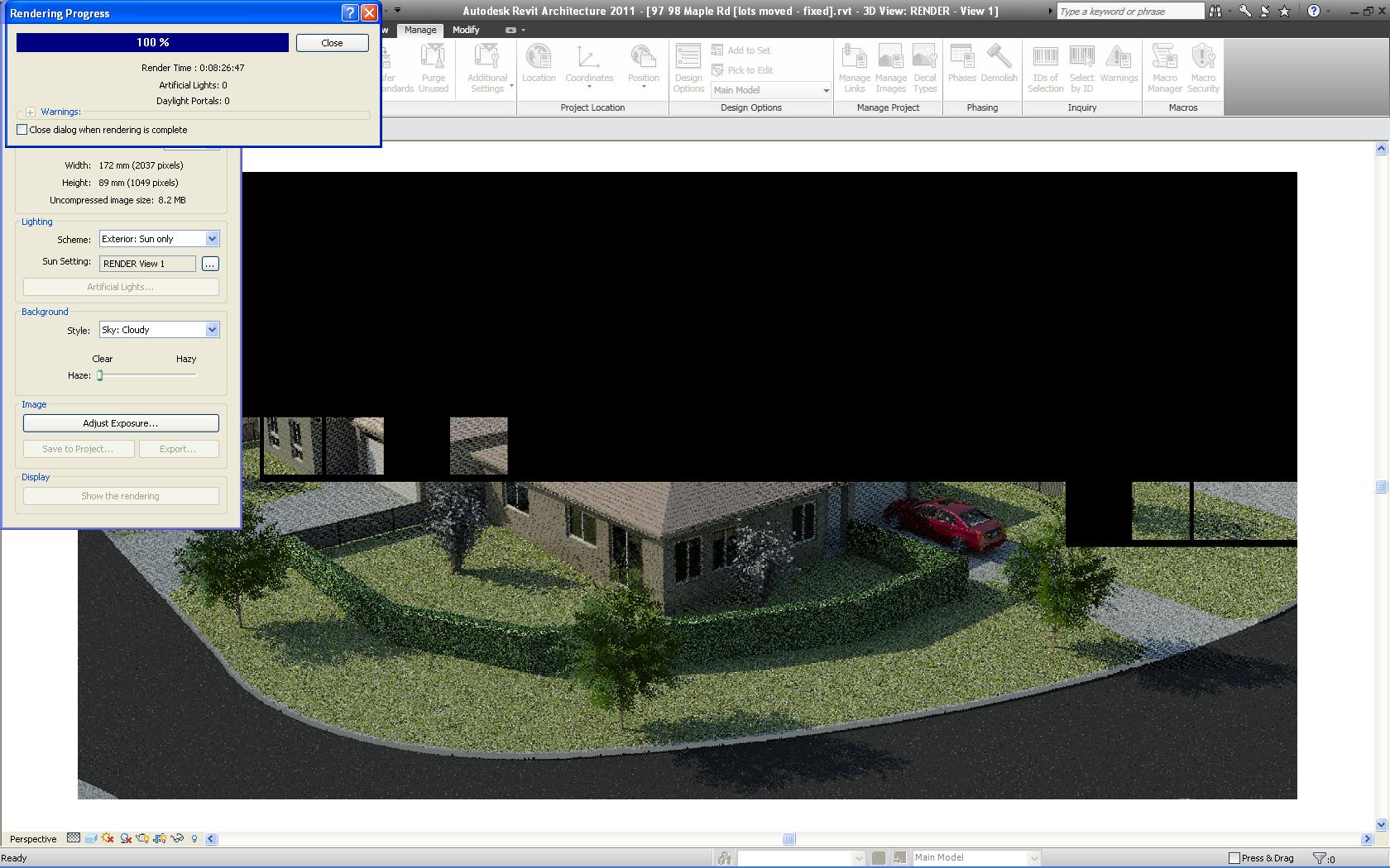

Hi guys, I've been trying to render this image at the office but it's driving me crazy. The client wants it printed A1 size. I'm trying to render with the "print" option on and "300dpi", which is not even enough but my computer either freezes or shows me this RUNTIME ERROR message during the rendering and doesn't finish it. (images attached)
The only way I managed to render it was slicing it up in 6 parts and render each one at a time to put them together later on in photoshop. But even this way I had to turn off all my planting otherwise it wouldn't work either. Now I have to render small areas with the planting and put it there on photoshop. SUCH A PAIN!!!! I'm afraid we won't be able to do this bigger 3D images anymore in the office...

if you are not running 64-bit software and 64-bit operating system this will be standard work flow for large files.

Actual file size is not your problem but it is your components.  I amagine that hedge is hogging a lot of memory and that many tress can also cause problems.  Some vehicles also use lots of memory and finally, do you have objects inside those houses that also have to be dealt with?

That missing image was supposed to come with some tree or hedge, but it didn't. Every time I render them I get that message. I reckon its not a problem since they look all right after rendering.
Theres absolutely nothing inside the buildings. They are empty!
And yes, those hedges are eating lots of memory. I even replaced them by normal sweeps with hedge material.

That missing Image (Lenha1.jpg) is part of the tree, you are using one tree i post in download section and that tree has that material...
