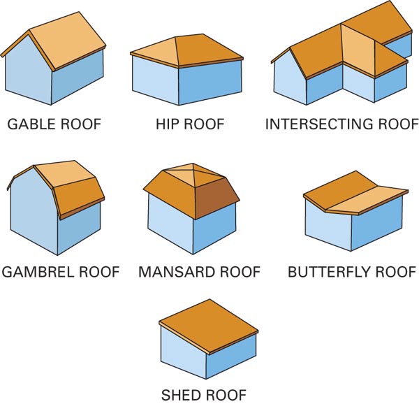

Hi guys, does anyone know how to make a shed roof in revit lyk the one shown??:
http://cmfac.groups.et.byu.net/tharmon/CM210/notes/Roof%20Systems/roof%20types.jpg
thx

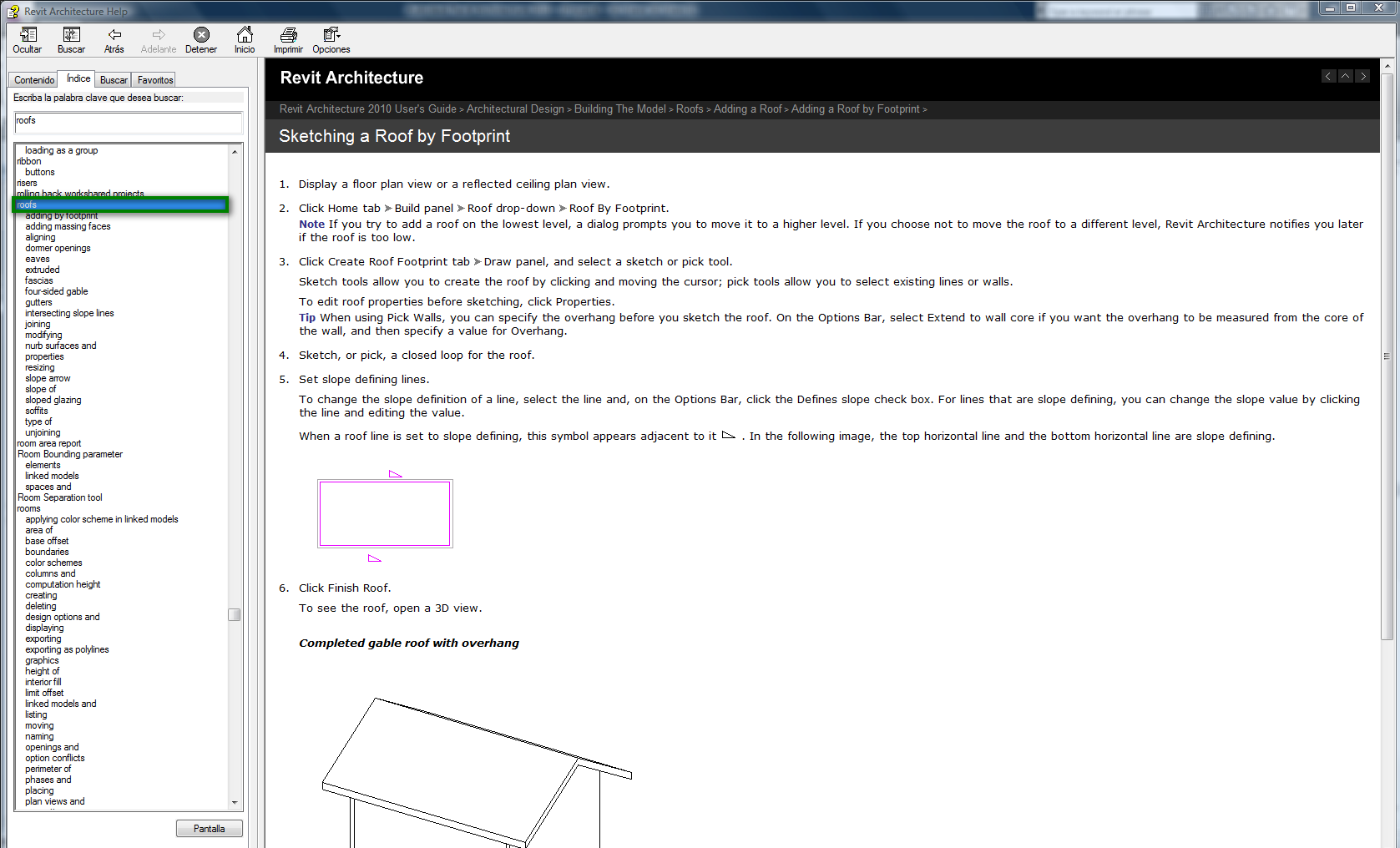

Sat, May 8, 2010 at 9:49:48 PM | Shed Roof in revit??
erland73
erland73 Avatar
Joined: Fri, Sep 7, 2007
738 Posts
4.5 Stars: 85 Votes
I think, you should read your HELP Menu for this......

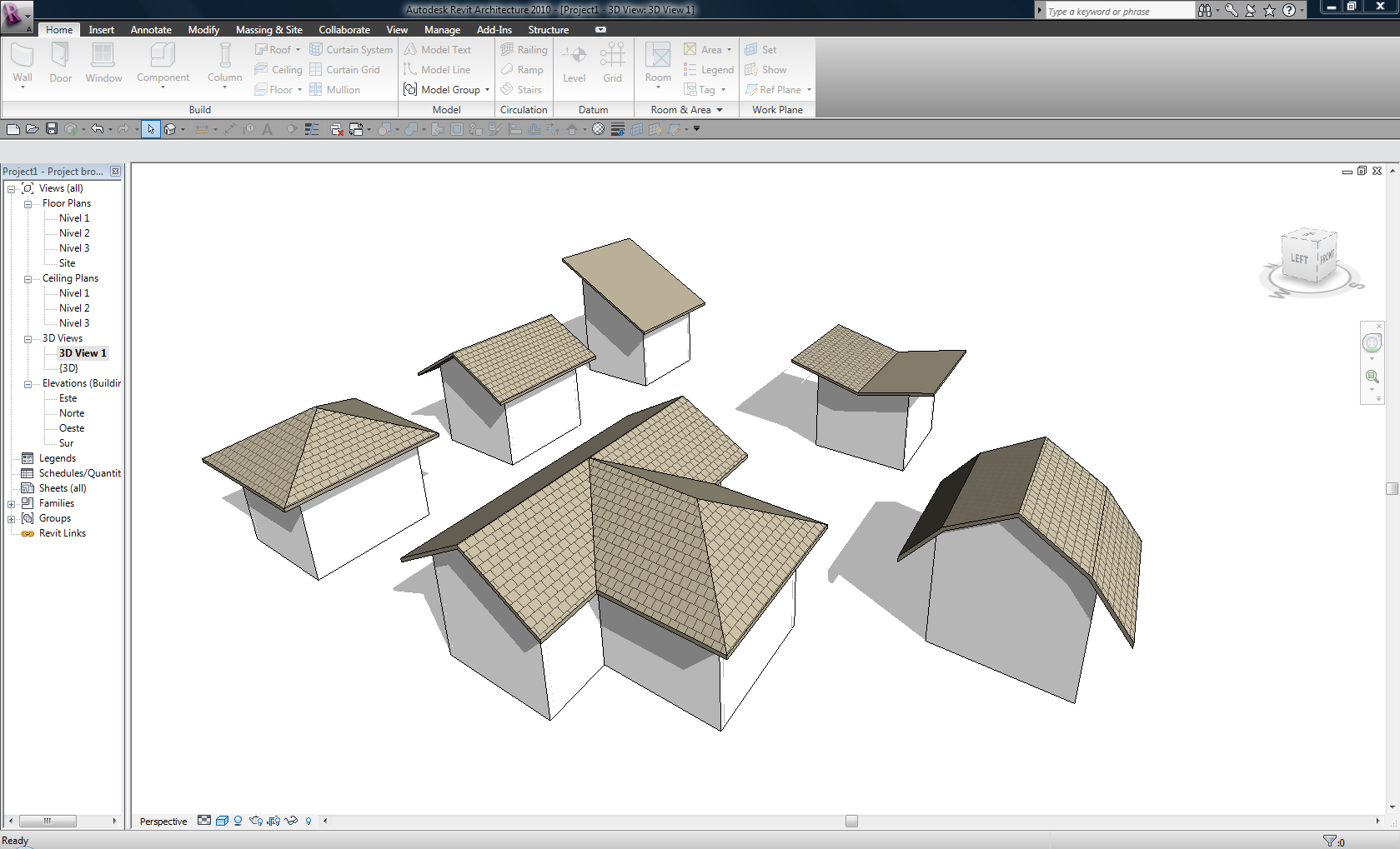

Sun, May 9, 2010 at 9:57:49 AM | Shed Roof in revit??
dgcad
dgcad Avatar
Joined: Thu, Mar 17, 2005
1231 Posts
3.5 Stars: 36 Votes
Excellent images of some basic roof shapes.
Here is a link to 10 CADclip videos on how to create these basic roof configurations.
