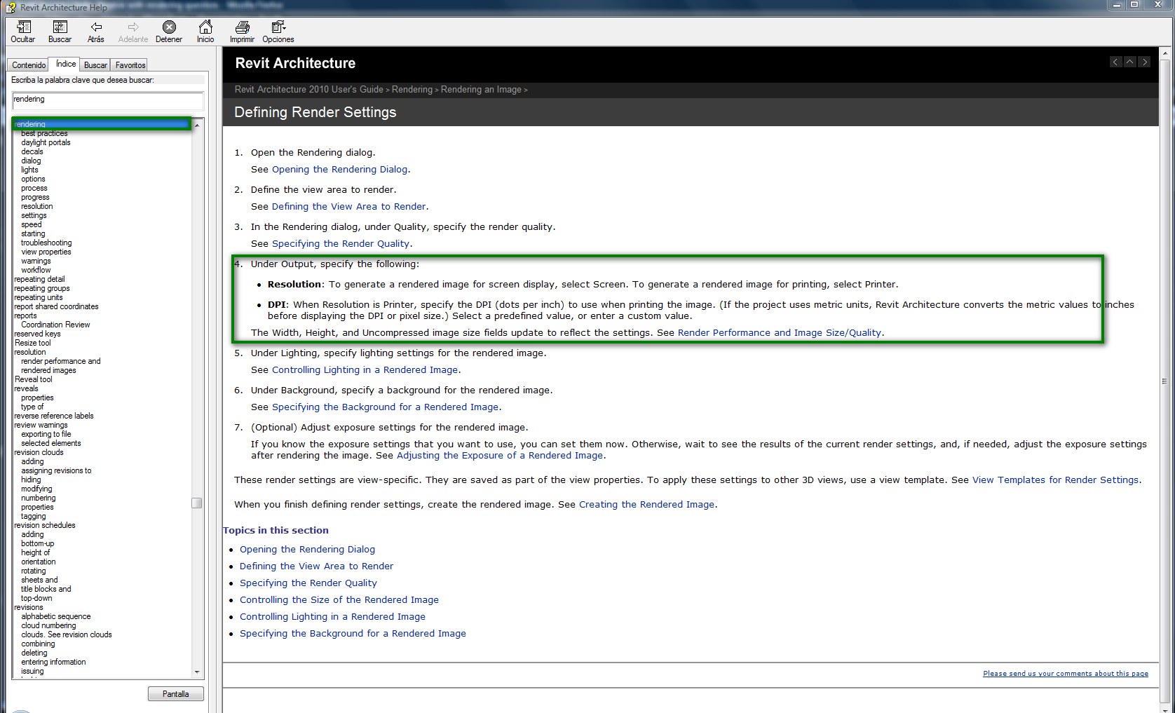

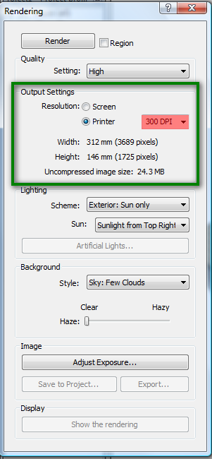

Hello everyone. I'm new to this whole Revit thing and I was having a problem with rendering image size.
Whenever I render something it is always the same picture size. I see people with these large pictures that are of high quality.  Whenever I render I click the "best quality" box but it keeps shooting out the same size jpeg. Any suggestions would be appreciated.
 Thank you. -Kerry

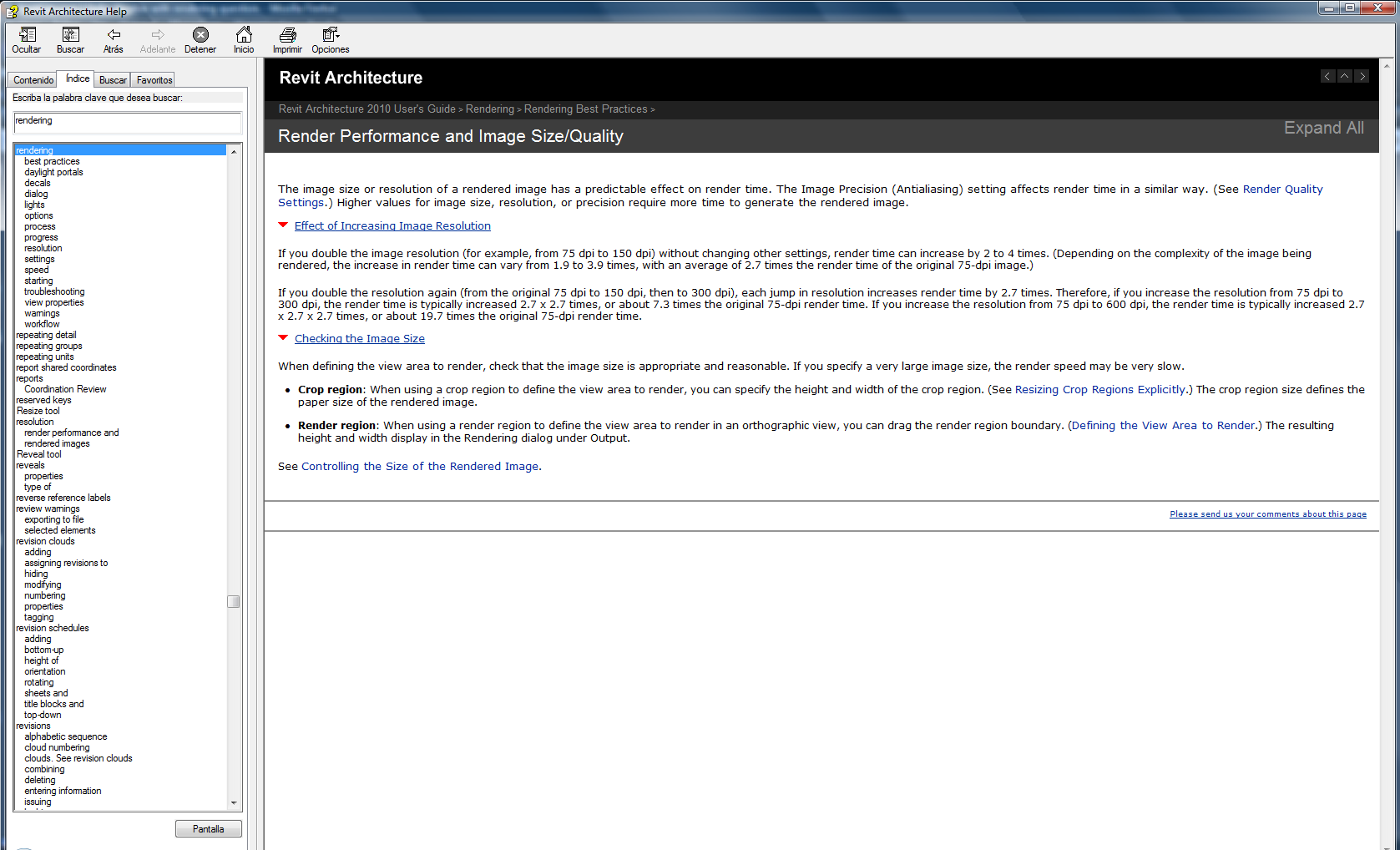

You should read your HELP Menu for this.....
