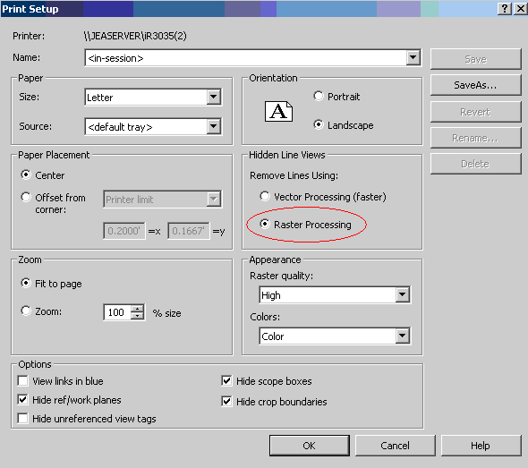

check the print raster image checkbox in print settings, and you will get your mass.

check box before printing > see attachment

See thread: http://www.revitcity.com/forums.php?action=viewthread&thread_id=8482
Masses always print transparent. Make generic models instead. On the Modeling tab, choose Create. You may of course choose to assign a proper category instead of the Generic Model category if one applies. Then visibility can be controlled through the Visibility/Graphics control as usual.
 Unfortunately, I don't think that you can convert a mass that you've already made into a model. Instead, you will need to delete what you have. If it's an extrusion you can edit the mass, copy the sketch lines and then paste same into the model sketch. That may save some steps if the extrusion sketch is complicated.
