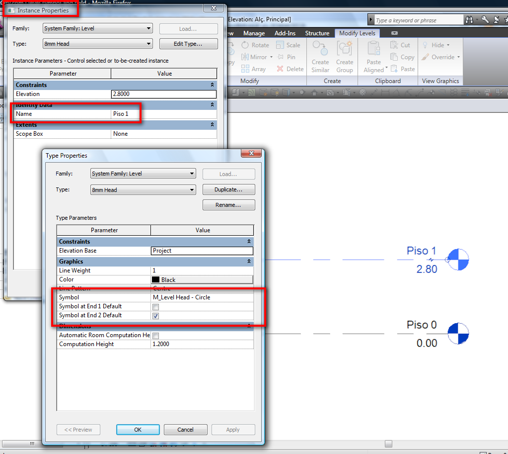

hi everyone. i am using revit 2009 and with our default drawing when i draw  a level it doesnt show the level head nor the name or the height. i click the ckeck box but still nothing happend. can anyone tells me how to turn it back on thanks in advance

Select the level and go to the element properties.  Select EDIT and check to make sure you have a SYMBOL selected.  You can also creat the SYMBOL to suite your standards.

5921 Posts
4 Stars: 205 Votes
Just to clarify....

thank lot for your help guys xoxo
