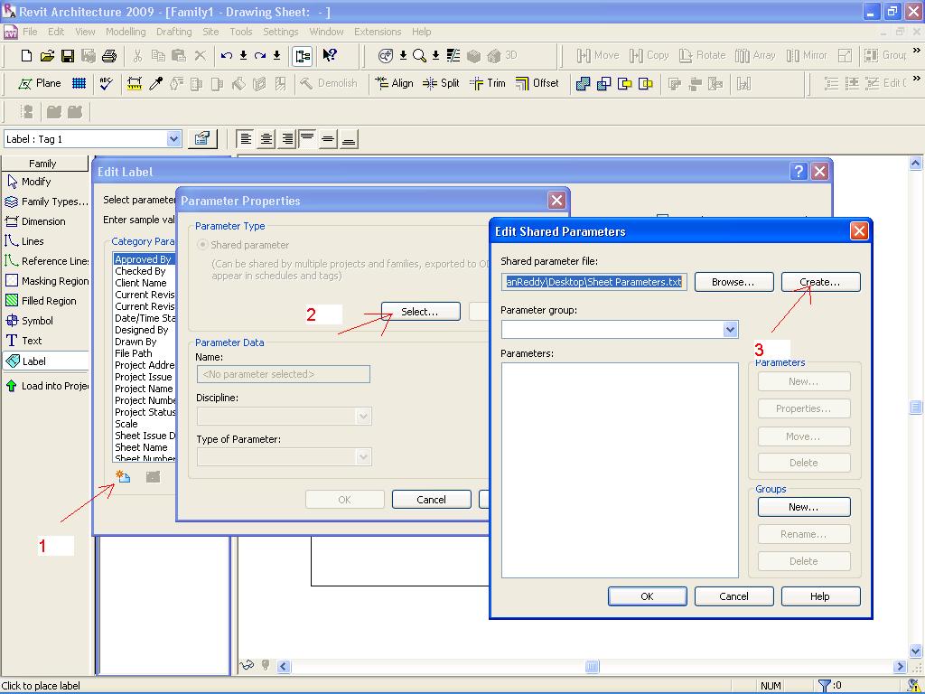

I want to create a label in a title block family that allows me to edit the content per sheet...very similar to the existing 'checker', 'approved by' or 'drawn by'.  How do you set up the parameter for this label..I have successfully created project information parameters before but can't seem to master this one....tried 'group' 'identity data' and 'category' sheets' but couldn't get it happening..
Any guidance would be good I'm just going in circles at the mo!!
Cheers  Dug
Wed, May 5, 2010 at 2:05:45 AM | Title Block Parameter
Pavan
Pavan Avatar
Joined: Sat, Mar 19, 2005
157 Posts
4.5 Stars: 3 Votes

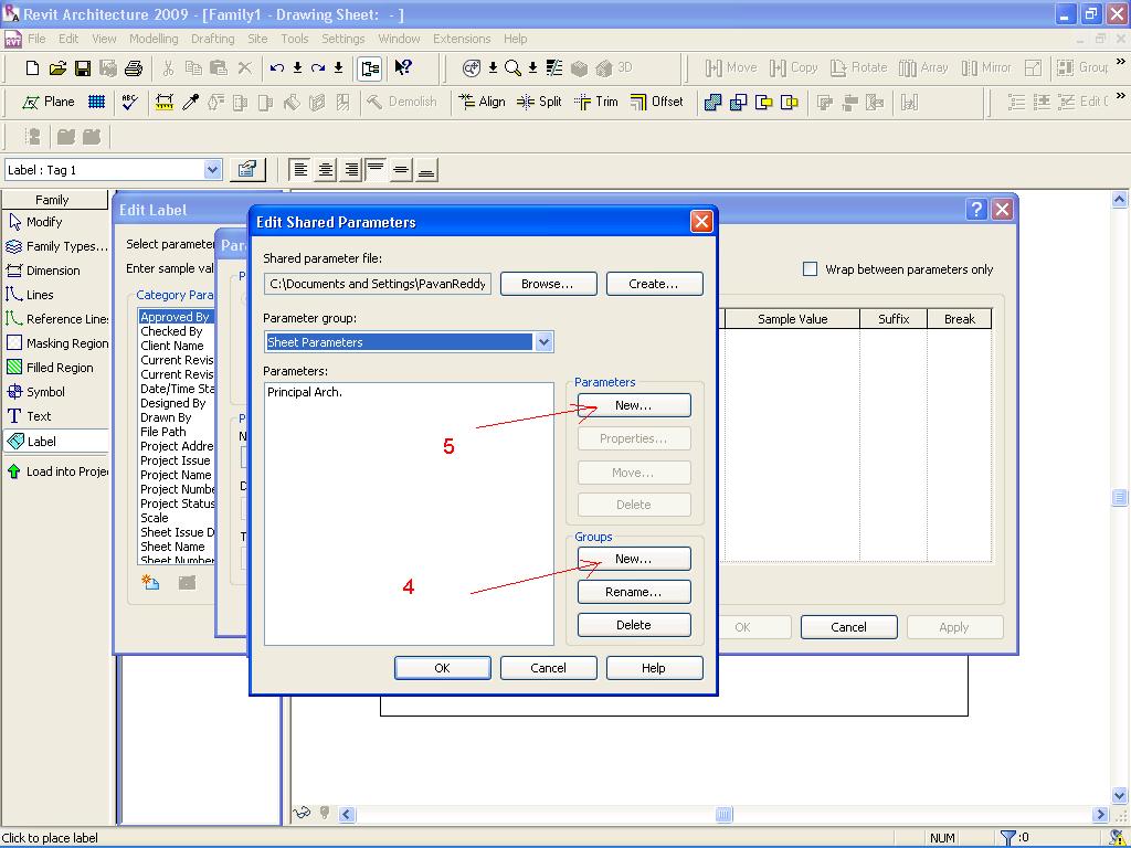

Open your title block and select label and click on the sheet where you want to place and follow attachment 1 and 2.

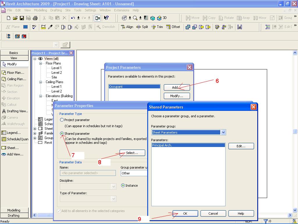

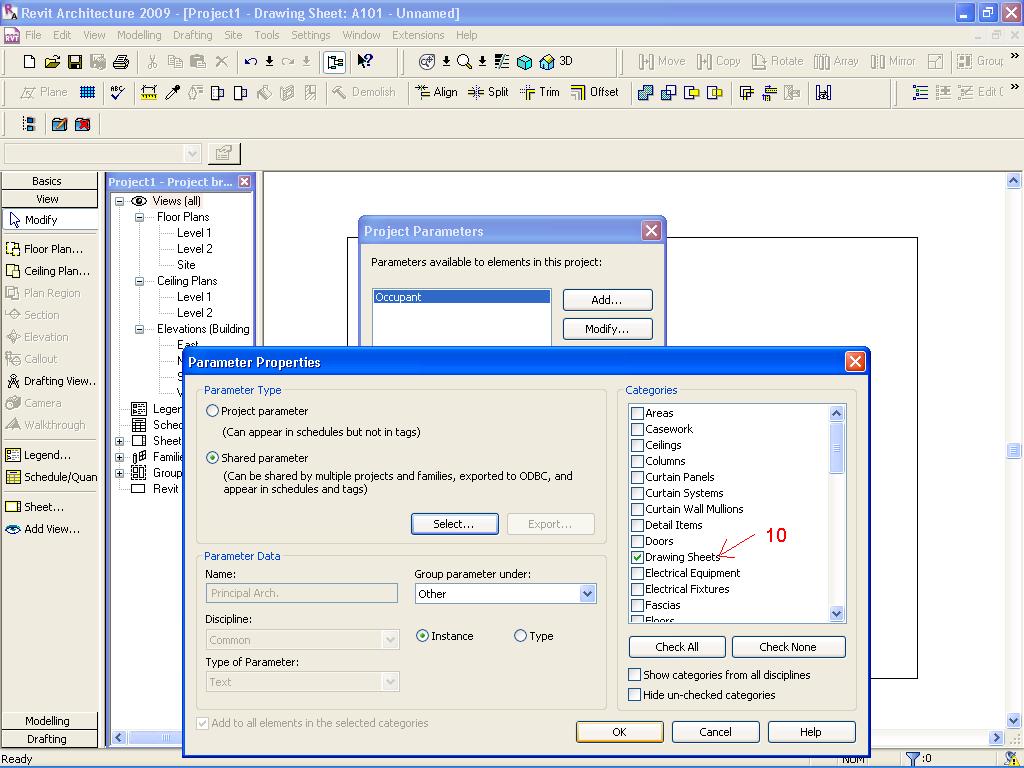

Open your project and click 'settings' 'Project Parameters' and follow attachment 3 and 4.

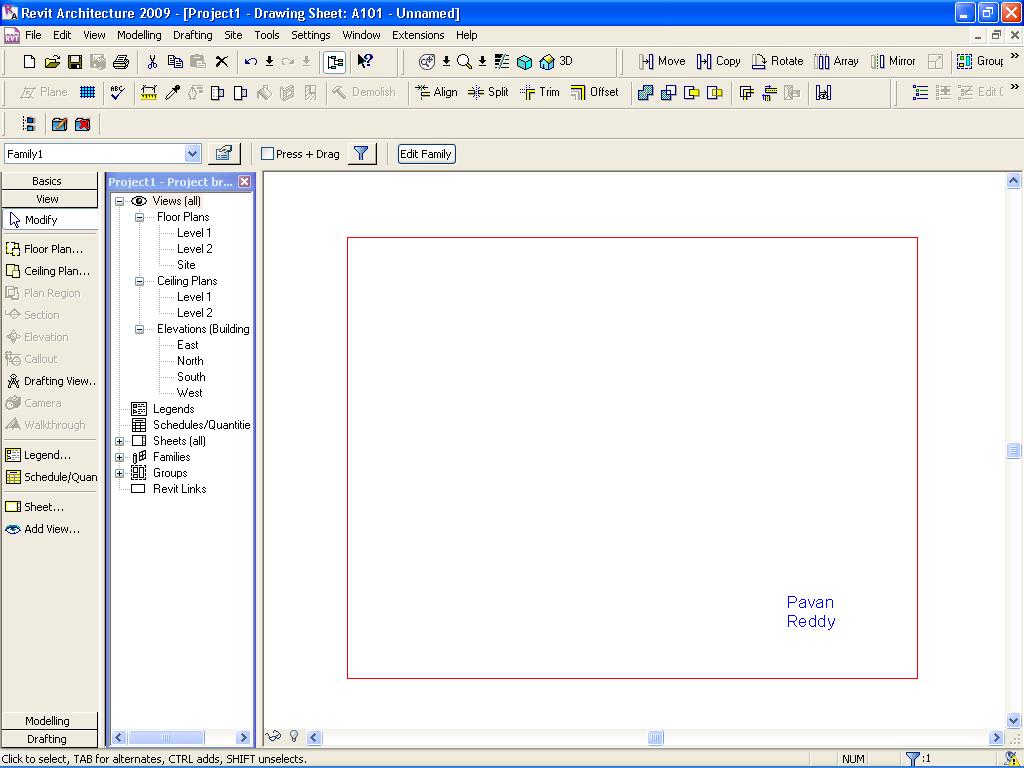

Now select the sheet and you can see a blue "?" highlighting, write anything as you wish.
