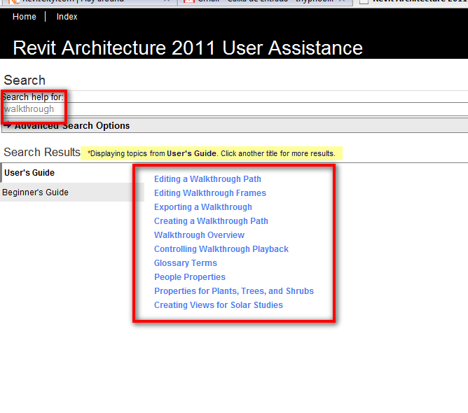

Check your HELP menu, it's your best Tutorial
