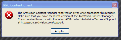

I Can't use RPC content in Revit Architecture 2011. (only the one who comes with the software)
Everytime I try the program freezes. Do you know a turnaround?

Yes I saw that but when I try to change the path.. the program freezes again..
so I need to go back to the original RPCs file..

I just received this email from Archvision:
Hello ArkitectJM,
This is a bug that we are working with Autodesk to fix.  Apparently their latest implementation causes Revit to hang if you have too many RPCs in the path of your ACM.  Try changing your ACM’s path to point to a folder with only a couple hundred RPCs and your Revit should open up just fine.  Hopefully Autodesk will have this fixed soon.  My sincere apologies.

Arki: I am having the same problem. Did not know how to fix it any help i ll appreciate Thanks!

Carrucha75.    Yes, I think you have to follow the instructions that Typhoon showed before:
http://www.revitcity.com/forums.php?action=viewthread&thread_id=20232
maybe you need to change the path of the ACM, or download and instal the latest ACM from Archvision.

i did not have success on fixing this problem may i ll wait until there is another person with the same error message.
