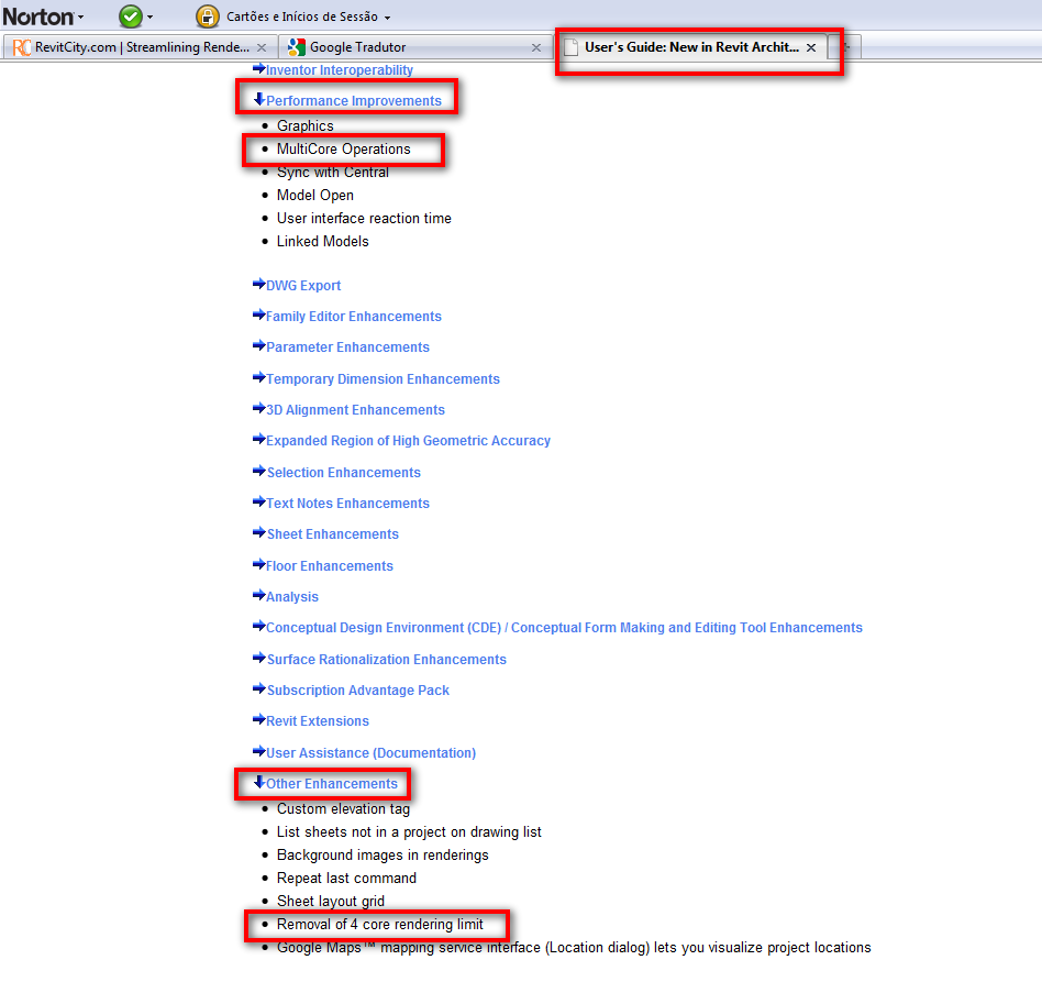

Interior renders in Revit are a pain in the heck.... But, in 2011 they improve a little bit... they removal of 4 core rendering limit which means it's a little faster depending on the machine you have.... but I still believe MAX is faster than Revit...
http://docs.autodesk.com/REVIT/2011/ENU/filesUsersGuide/WS73099cc142f48755-751de9951262947c01c-3c22.htm
